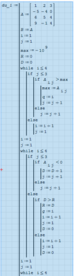

Hello, I need some help solving this problem:
Given matrix A(n,m). find the row with the most negative elements and replace it with the row with the largest element of the matrix.
Thanks!

i tried this sollution but its too long anyone can size it down ? 😄
got the awnser wich is correct but too long or there is another way of doing it?

It is kinda homework and its tasks for getting ready for exam wich is algorithm, and yes i was using SMath Studio cuz we at collage use an older version of MathCad and with the new version i have no idea how to work with it.
it should switch given numbers given in the matrix they are from the head there werent like specific numbers to write.
the person below did it right but way much higher level 😅 wich i dont really understand.
is possible to do it like mine? i believe u can do it with  1 or 2 cyckles but cant figure it out how 😅

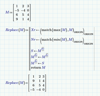

So I would suggest that your first attempt should be a pair of nested loops (for row and column) to run through the whole matrix and find the position (row number is all thats needed) where the largest and the smallest matrix elements are found.
Initialize two variables maxval and minval  both with the first matrix element.
Then in your loop section ask if the current matrix element is larger than maxval and if thats the case, set maxval to this value and store the row number in a variable maxrow (corresponding to Lucs Xr variable). Similar with the min value.
Now you know the two row numbers and the next step is to exchange these two rows.
Luc did this by using the row selector and an intermediate variable S. If this is not available you may transpose the matrix and use the column selector or do it by another loop element by element.
You know that you can swap to elements A and B by using a temp variable?  temp:=A    A:=B     B:=temp

Anyway, A Mathcad Prime program to do what you want is:
A Prime 8 file is attached.
