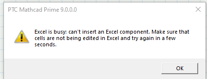

April 27, 2023
Having same problem now when Inserting Excel Component . Using Mathcad Prime 9.0 and Excel 2016. Mathcad.PNG
