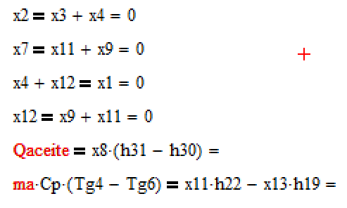

I am doing this exercise about a combined cycle where some of the enthalpies are known.
The problem is when i try to solve the system the error "This variable is undefined" constantly appears.
I have tried both of the systems i know about describing the solution:
 Solution:=Find(x1,...) and (x)
                                       (y)  :=Find(x1,...)
Hope there is solution.
Thanks in advance.

You did not set all the initial conditions.

Yes, you are completely right. I forgot to copy those variables. Thanks @VladimirN
It shows me the same error with Find and i have tried to use Minerr but shows nonsense results, knowing the differences between them, so i will continue finding a solution.

Better to use the lsolve function for this problem! Not given-find!
I think I have to disagree with you, Valery.
Using lsolve you are forced to structure your problem nicely. The advantag of a solve block is that you can make a mess of the problem.

The main problem i have just realised is that in some of the equations some unknown variables are multiplying each other, such as x8 and h31. I thought that the idea of using lsolve was great until i realised about that.
I would change the equations and assign values for the h24, h31 and h32 so there isn´t any variable multiplying another.

The problem is that there are some variables that multiply other (x8*h31), making a non linear system, or am i wrong?
That makes impossible using matrices using a column for each variable.
ValeryOchkov
(To:IG88)
Non linear.
