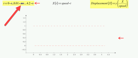

I did no exact timing but it looks to me like calculations need much more time in Prime than in MC15
BTW, omitting the vertical line segments in a step function would be perfectly correct from a mathematical point of view but I understand that its undesirable for an engineer.
There is a simple cure, though.

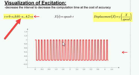

My suggestion of a step width of 0,01 ms in the range was far too low. It should read 0.01 s which is good enough for the plots.
The range 0s, 0.01ms .. 4.2s forces the plot to be evaluated at 4.2 * 10^5 positions. Mathcad could handle that many points (nearly half a million) but Prime seems to have different limits and it falls back to this strange looking plot where you could not change anything (line style, thickness, .. ) other than the colour.
Changing the range to read 0s,0.01 s .. 4.2 s gives us 421 points which is more than enough for this simple rectangular function. Changing the step width to 1 ms for 4201 points should be OK, too, of course.
Even simple 2D plots always were one of the many drawbacks in Prime and PTC was not able or willing to improve it. You may have noticed that there are not axis labels, no grid lines, the possibilities to customize the plot are much more limited and simple things like changing the axis limits are much more cumbersome.
In Prime 5 PTC has introduced a third party diagram component (look at the "calculate" ribbon for it). I don't like this add-on as its very slow and laborious to handle, does not scale correctly when used with a high resolution 4K display (making it nearly unusable) and does not support units (a no-go in a program like Mathcad/Prime).
Nonetheless, if you decide that you like Prime despite its drawbacks, you may give this plot component a try, too.

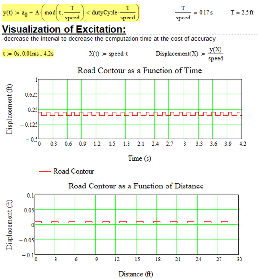

Here is the worksheet I am trying to use. It is attached. I hope all can see it.
I don't see where you implemented Luc's function. I just see an attempt to approximate the pulse via a partial sum of a fourier series.
What I noticed is this:
1) It seems that you wanted to define a range for t, but the region t:=0s,0.3s .. 4.2s is not a math region but is mere text. If you create a true range you should use a much smaller step size, like t:=0s,0.3 ms .. 4.2 s
2) If you define t as a range with the correct time unit, the plot "Road Contour as a Function of Distance" will fail because you used "Displacement(X(t))" on the abscissa. I guess it should just be "Displacement(t)".
The name T for the period in distance is a bit misleading. As you want to define y as a function of time, the correct period seems to be T/speed.
Take a look at the attachment if it is what you are looking for.

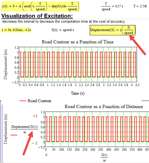

I missed one error in the definition of your displacement function.
See the picture below or the attached sheet.
With this change its quite correct to use "Displacement(X(t))" in the second plot. But "Displacement(X(t))" should give you the very same result as "y(t)" 🙂
In the attached sheet I changed the displayed units to inch instead of feet as you give the measurement of the boards in inches. Not sure if this makes sense.
According the speed. Its the numerical integrations that take that much time. Every calculation of an integral means a lot of iterations to be done and this is done for every single point which is plotted. Thats the reason I suggested less values in the range variable t used for plotting. Prime should (not sure if it really does as we would like it to do) take advantage of more cores by multithreading and can use more RAM. But in my opinion "upgrading" to Prime would rather mean downgrading, considering the many missing features compared to Mathcad 15. I remember some threads here in the forum where multithreading was the cause for some troubles and it was suggested to turn it off. Can't remember the details, though.
But I suggest that you give it a try yourself. Download the trial version of Prime 6 (it will run in full mode for 30 days), convert your worksheet to Prime and see if the speed increases significantly.
Here the screen shot with the necessary change in the definition of "Displacement":

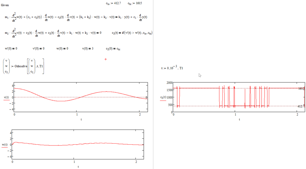

Werner,
I am attaching another model I have been working on (basically the latest one you posted, I have just modified some of the initial constants). I have a procedural question. Near the top of the worksheet is a variable named c2.
It is the value of a typical shock absorber like would be on a car. Currently I have it as a fixed value. However, in reality a shock absorber's damping value is a function of velocity (in my case, v(t). Since it is being used to calculate v(t), I assume I cannot make it a function of v(t)? If not, then can I at least make it one value if v(t) is positive and a different value if v(t) is negative? If so, how would I do that? Would I set it's as a matrix with one value for v(t)>0 and another for v(t)<0?
Thanks again for all your help.
Mike
In my previous post I misspoke. It is a function of velocity, and of the sign of the velocity. So if velocity is positive (increasing), it is one range of values, and if velocity is negative (decreasing), it is a different range of values.
If I cannot do that, then can I set it so that if the v(t) - w(t) is increasing (in other words if the shock is being compressed) it is one constant value, and if v(t) - w(t) is decreasing (shock is being extended) , then it is a different value.
Mike
You may make c2(t) a third function of your solve block if you can formulate an equation how c2 is dependent on v.
Another way (not sure if thats applicable) could be to make the solve block a function of c2, so you can solve it for different values of c2.
But you can't decide which value c2 should have after you calculated v(t) as the calculation of v(t) uses the value of c2.

here is an attempt to do what I think you are looking for. You sure have to change the function c2(v) to your needs.
Werner,
Is there a way to have c2(t) be one of 2 values, as follows:
If v(t) - w(t) > v(t-delta t) - w(t-delta t) then c2(t) = 412.7
Otherwise c2(t) = 1615
Mike
Sure,
use the 'if' function: if( <condition> , <value if true> , value if false> )
In your case:
Luc,
When I put that in the previously posted worksheet, the v(t) turns red and tells me it is undefined.
You would have to provide a value for delta_t.
I am not sure if the numeric algorithm used in the odesolve-block will be able to handle a function with that discontinuity, jumping all of a sudden from 400 to 1600.
You may give it a try and if it does not work you may try using a function with a steep slope instead.
Furthermore ... how should Mathcad know v(t-delta_t) at the start, when t=0 ??
Maybe you can try to formulate the condition differently. In a previous post you said the trigger would be just the sign of v(t).
Maybe you can use v'(t) > w'(t) to achieve what you are looking for? See below
MC sheet in version 11 attached (for Luc to be able to join in 🙂
