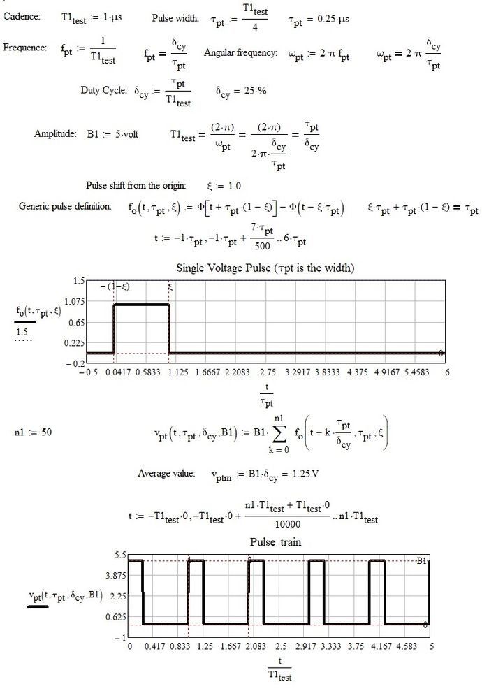

I did some changes (see picture below) but the first equation sure should read differently as with the function I came up with we get very high values at the end of the interval (10^13) which probably is not as expected.

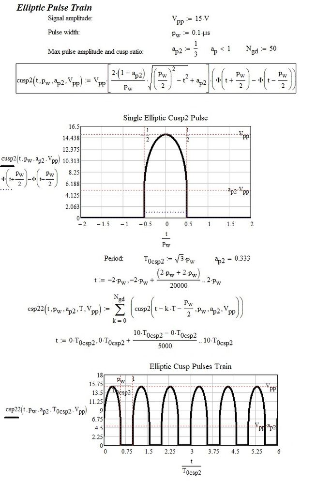

(To:mlernst)

Thank you for this interesting idea. However, I need it to be rectangular (as proposed by Luc), not elliptical.

Ok!
that's better?

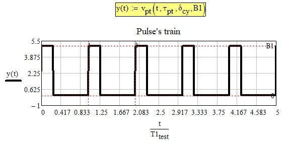

That is definitely better. Now my next question - how do I turn that into an equation of the form y(t)?
I have a lot of other equations on down the Mathcad program that are using y(t) in their evaluation. This program is using this pulse as a "description" of a road surface that is then being used to evaluate the suspension on a vehicle that is driving over it.
-MFra-
(To:mlernst)
it is very simple:

Could you possibly send me this as a Mathcad file? I must be entering something incorrectly. It is not working for me.

I've attached the file.
