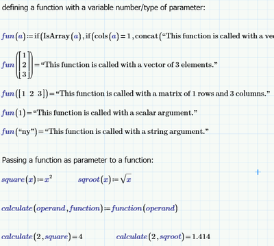

In Prime you cannot create a function with a variable number of parameters. However, you can create a function that accepts a vector, or a matrix, as parameter. Within the function you can determine the size of the vector or the matrix.
Below some illustrations of what you can do in Prime:
Note that when you pass a function (name) as a parameter, you cannot inspect the parameters of that function.
You can pass a complete function call as a parameter to a function, e.g.
The inner fun(1) results in a string that is passed as the argument to the outer fun, resulting in the response that it's got a string.

The number of elements in a function is fixed as the definition of the function. When you change the number of elements, a new function is defined.
As Luc shows, you can use vectors or matrices on elements to change the number of elements and get the result you want.
