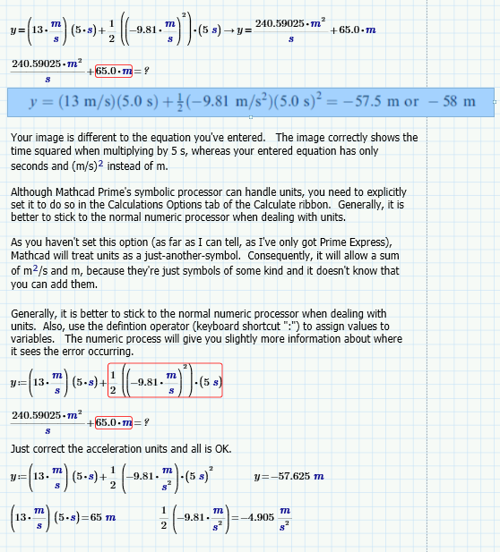

I'm trying to input this equation into mathcad, but I keep coming into the problem of incompatible units. Thanks for the help. This is also my first time exploring physics so it may equally be my fault. The equation is in the image attached.
StuartBruff
(To:RG_10050841)
Mathcad Prime Express 7 worksheet attached.
Stuart
Edit:  The end of my 3rd paragraph should read "... and it doesn't know you can't add them".
Stuart

Additionally to what Stuart already explained in detail you may consider using the built-in gravity constant g:
Please also note that to assign a variable (like y) a value, you have to use the assignment or definition operator (":=") and not the comparison equal to (the fat "=") as you did.
