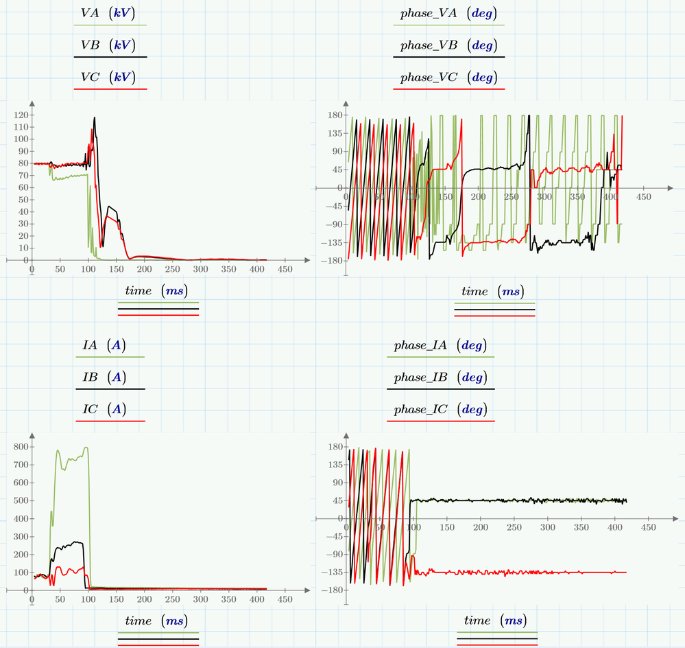

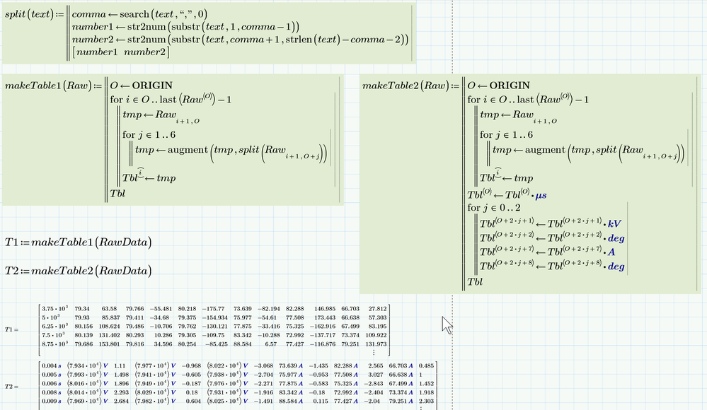

Here are two functions which build the whole table. One without and the other with units applied. You can't demand for specific units for each column when displaying the full table but you may display every column with the unit you'd like to see (degree e.g.)

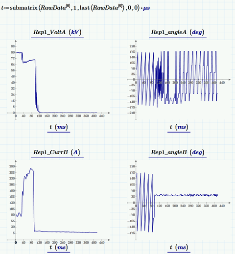

Ideally built-in function READFILE should be doing this, but I'm afraid your datafile is too complicated for READFILE.
Consider using the funcion Vec2vec() on each of your "[....]" elements.
See attached Prime 4 file.
If you want you can multiply the second element of the Vec2vec result array with deg, to get them look like angles.

Here is a utility function which might come handy
(To:ppal)
