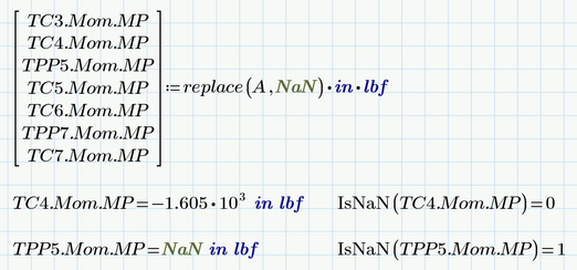

(To:SFares)
Just a side note.
When you replace non-scalar values by NaN's, you can add the appropriate unit as Prime allows adding units to NaN. "IsNaN" still works OK if you later need to check if a variable was replaced by an NaN or has a numeric value:
You may also read, replace strings and add units in one go, however, readability suffers as a result.

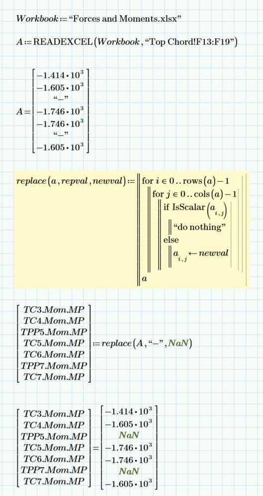

Doh!
This is what comes of changing one's mind whilst typing.  There is no need for the input parameter repval, as it isn't used. The replace function simply replaces any non-scalar value with newval.   However, a more general replace function might prove useful, which uses the repval as an input argument, so here are two versions of replace, side by side.
