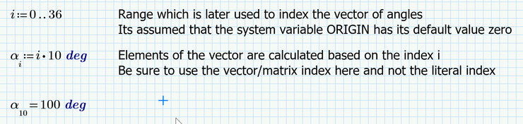

There are different ways to create the vector alpha you need. A very convenient and comfortable one is to use an undocumented trick. If you follow the definition of a range immediately by an inline evaluation, the range is turned into a vector.
You won't see any differences when you display it, but you see the difference when you try to access a single "element".
In the following screen shot it fails for beta because its a range and you may think of a range as being an implicit loop rather than e sequence of numbers:
Here is a more "legal" way to create the vector alpha

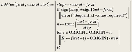

What Mike (not Mark 😉 ) had posted in the thread you linked to was a utility function which could be used to create a vector, given the first and last element and the number of equally spaced values it should contain. What he posted was just a jpg picture, so you sure should be able to open it.
When you search the forum you may find quite a lot of different utility functions to create a vector.
Here is another one which follows the range definition - its arguments are first, second and desired last element of the vector  (which might not be taken as a value, depending on the first and second value - similar to the behaviour of a range definition):
