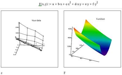

See please the Mathcad 15 sheet in attach. You can convert it into Mathcad Prime. Or I can do it myself if you can't!
See please the picture! You can choose more optimal function for your data - not the 2-d order plane!

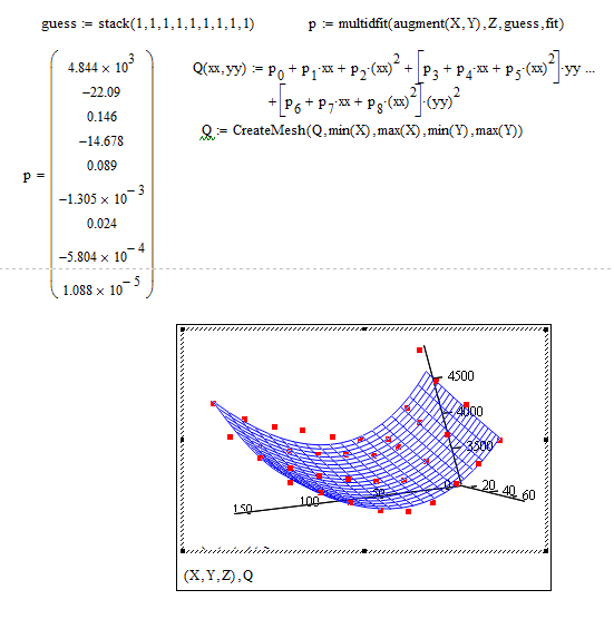

At current moment I have the following:

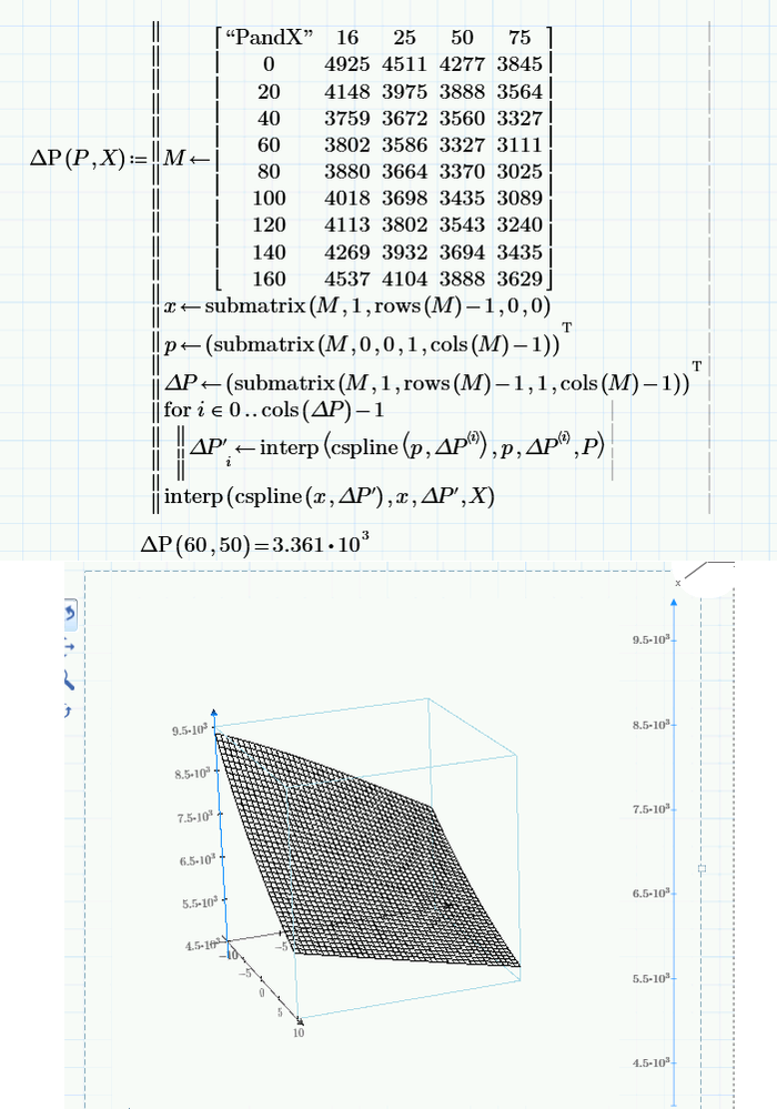

Search help for multivariable regression.  The function "regress" will do a polynomial fit regression.  Anything but polynomials will require more thought and effort.
The regress function need a square matrix of the date! You can delete some rows! Or add some rows!

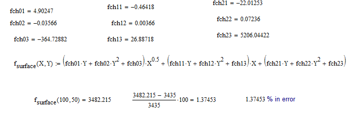

For this you are best to get the equation of the surface.
This is an entirely different approach to the problem I have used professionally to determine the underlying mathematics on a surface in heating and cooling mills in plants.
It involves determining the equation that matches the surface in one direction say the X direction.  Same equation but different coefficients at each  Y position.  Usually can be done with three coefficients in the equation.
Next you find an equations for the variation of these coefficients in terms of the Y direction.  Again only three coeffficients are necessary for each coefficient.
I will try to solve your problem today with my students in class (IT-lessons)!
… but the 2-d surface is good - the max delta is 6.5%!
