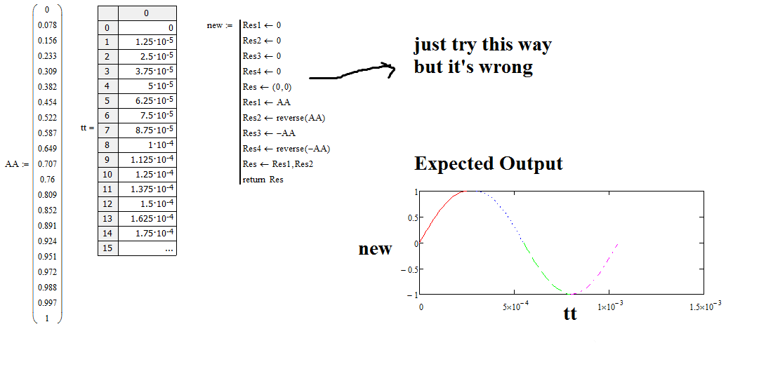

how to plot repeated value ?
Eg:

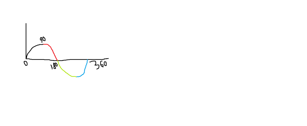

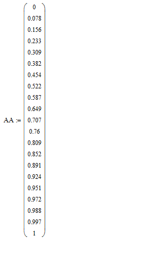

for example i want to plot sin wave, i have values for 0-90 degree and i want to plot for 90-180 degree by reversing same data and so on till 360 degree or (0 to 2pi).
In the 1st graph, AA=[0,0.99,0.98,0.97,...1],size of AA is 20and i'm just repeating by modifying same data "AA"
Solved! Go to Solution.

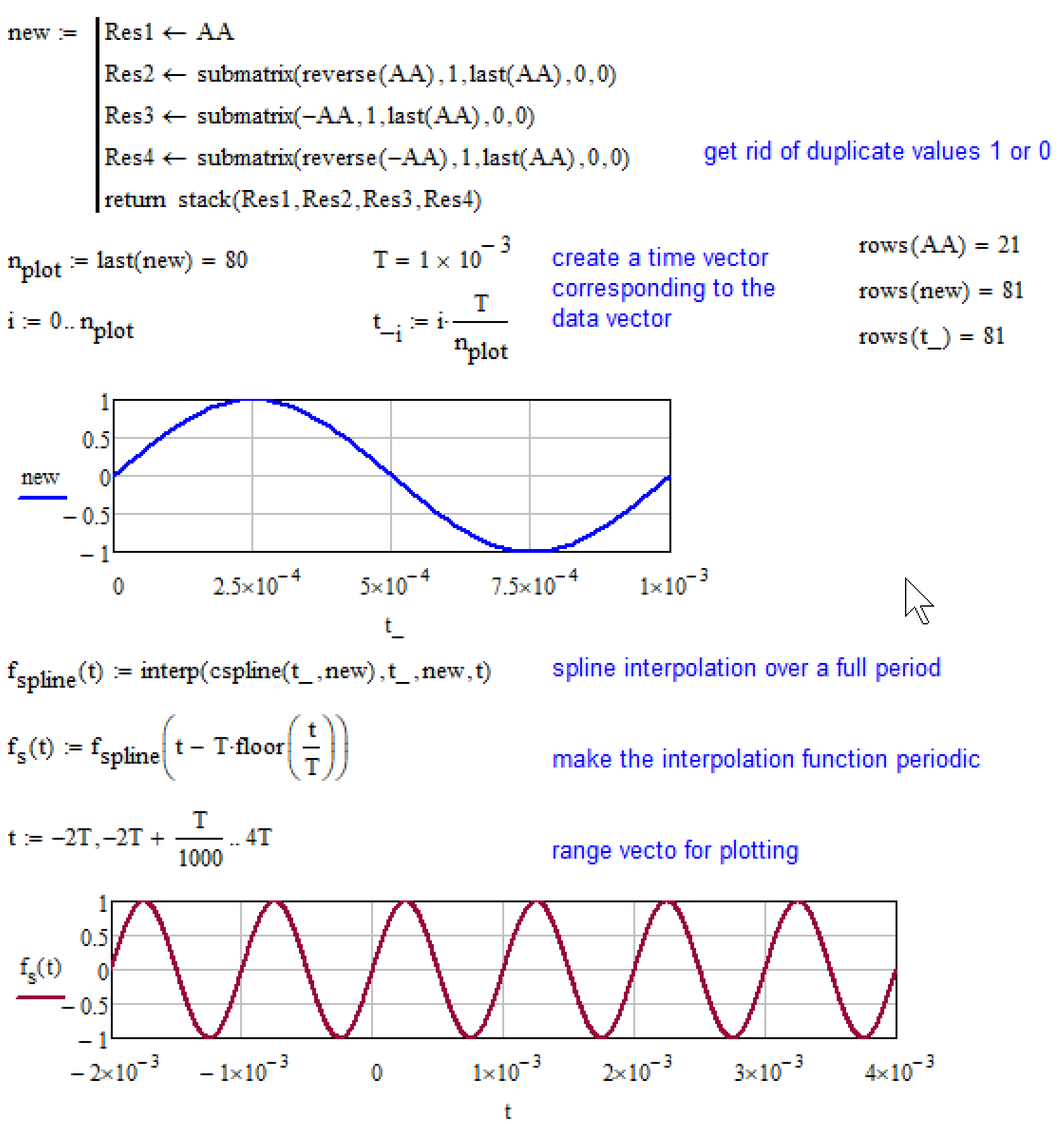

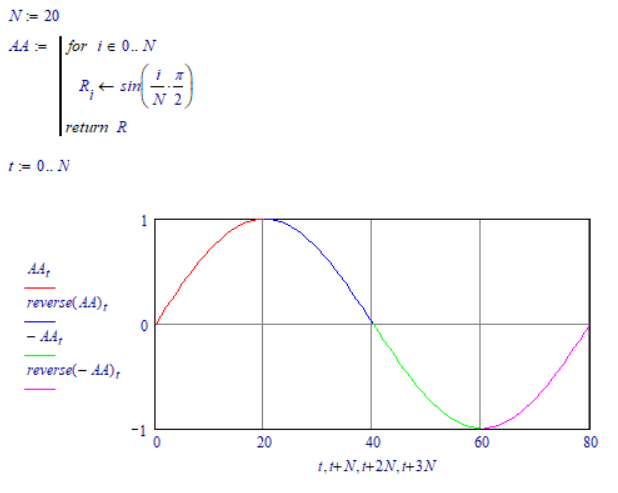

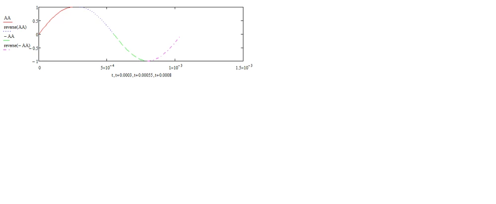

I think? the function you are looking for is "stack". Doing this you loose the four colours.
I have generated AA from Sin as I am not retying your AA by hand.
Cheers
Terry
No, i don't want to use sin function ("sin") without using "sin" but using set of values like "AA" only,
Note: only values of "AA" and i want to do all the operations on programming it self not on graph,
Ex:
Thanks for reply please look my modified reply above ! i need like that
Cheers
Terry
Don't be silly.
I just used the sin function to generate the array AA. How you get to any AA is up to you.
I showed you how to plot the data using the inverse and reverse once the AA data is known.

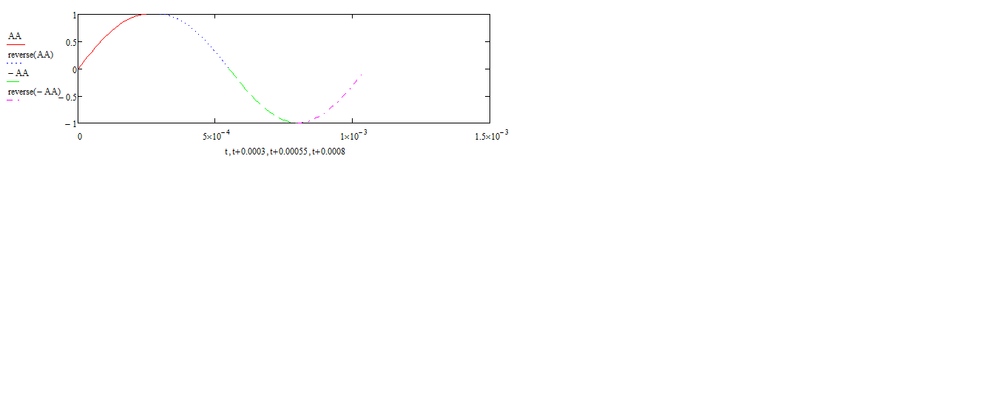

i have uploaded mathcad file and please check ! i explained my prob. clearly !

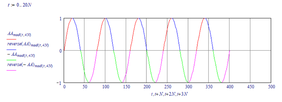

terryhendicott- Thanks a lot but how to get continuous waves, i want to repeat that same wave for my entire "t" please look once my mathcad file
Continuing on my first answer: change the plot parameters like this:
yes i understand wat u want to say but i need it in my mathcad file because there is some problem for ex: if i use AA[t] in y axis and [t] in x axis it's not working that's the problem ! please check my mathcad file once.
Is your 't' a range, or a vector?
Note that:
A range is a list of successive number that you create by typing
t:0,1;5
to get:
t:=0,1..5
A vector is a list of items (not necessary numbers, not necessary successive) that you can index ( with a range variable for example) You can create a vector T for example by typing:
T[t:t^2
to get:
Tt:=t²
and using the range t from above, T would have elements 0, 1, 4, 9, 16 and 25.
You cannot index a vector with a vector.
