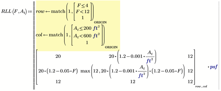

BTW, here is a slightly simpler way to get the correct matrix indices 'row' and "col'.
IMHO its clearer and easier to read if we just check for the upper limits. Because of the index ORIGIN we are still correctly using the first index where the condition is fulfilled.

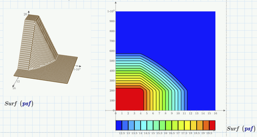

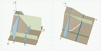

EDIT: Added an attempt to graphically show the nine areas defined by the matrix.
Unfortunately Prime's 3D plots miss a lot of standard formatting options like some sort of transparency. And the contour plot does not allow for additional traces and does not offer marker lines 😞

Took a different approach as Engineering is full of such tables.
Created a matrix of the table so you know the equations are right and in the proper place.  Easy to check.
Created a function that gets the correct index into the matrix.  Easy to check.
Like I said easy to check and an error in sheet now corrected
