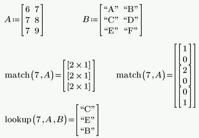

What is the difference between ( match) and ( lookup ) function in mathcad prime 11

Match gives the location(s) (index/indices) of the element(s) found, while lookup gives the value(s) of all/an element(s) in (a) location(s) that correspond(s) to the element(s) found.
With matrix:
tells you that the 2 is found at row position 1 in colum 0.
gives you the value in column 1 of that matrix, at the same row where 2 is found in the first column (column 0).
You can also get the value of the element found, by looking up in the same array as where you search...:
but the usefullness of this may be questionable.
As Werner shows, you get multiple results, if the value you look for occurs multiple times in the array.
(To:YA_10963798)
match(z,A) returns a vector of indices of the position(s) z is found in matrix A
lookup(z,A,B) returns a vector of values from matrix B from the position(s) z is found in A
See the Prime help here: Lookup Functions
Simple example:
EDIT; Oh, too late—Luc has beaten me by one minute. 🙂
