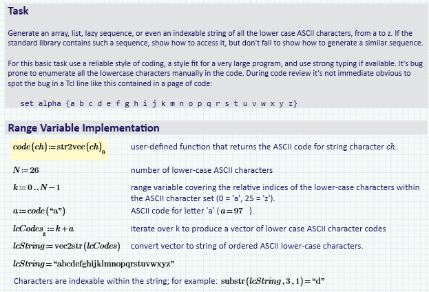

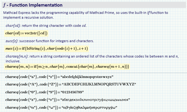

I've added the following solution to the Rosetta Code task: : Generate Lower Case ASCII Alphabet
References:
1. http://www.rosettacode.org/wiki/Generate_lower_case_ASCII_alphabet
2. http://www.rosettacode.org/wiki/Generate_lower_case_ASCII_alphabet#Mathcad
Please feel free to add your own versions, additional to or replacing mine if they're an improvement.
Cheers,
Stuart
(I was going to use succ to generate the sequence of characters, but didn't in the end.  I'm just too idle to remove succ from the worksheet)

Invitation accepted:
Does:
But also:
Neat, Luc ... but it ain't over until Brünhilde sings her refrain on Rosetta Code. 😈
Stuart
