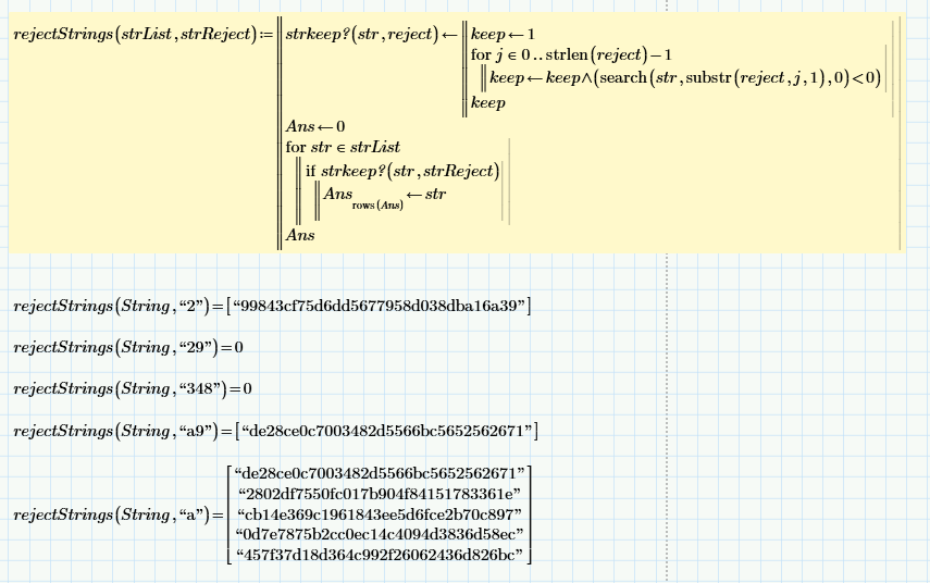

How do I select which particular loops to skip. Depending on a condition I may want to skip loop "k" or "j" or "k" AND "j" and just get the next "i"
How do I go about doing that in similar scenario to below:

Both of your breaks only exit the "k" loop.   After, for example, your program finds the first "reject" character, it goes and looks for the second "reject" character.  If that character isn't in the string and your modulus condition is met, then the program will add the string to Ans.   You need to arrange your code so that a rejection of a character exits both the "j" and "k" loops.

(To:Werner_E)
And here's a variation on the theme, for purely pedagogical purposes (and to squeeze in an alliteration).
The example shows both the use of a local function to do the checking and of the for loop to iterate over a vector without the need for a loop iteration variable.  It also demonstrates the use of boolean operations to update the keep/reject variable.

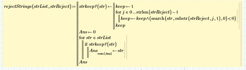

The (slightly) modified version of the function below shows how a local function can effectively use a main function argument as a "global" variable, thereby removing the need to pass the rejection string as an argument to the local function.
Mathcad Prime 7 worksheet attached.
