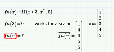

Typically, if you have a function that works using a scalar argument, you can use it to evaluate each element of a vector by "vectorizing" it:
(To:BG_7818704)
Vectorization is a powerful operator.

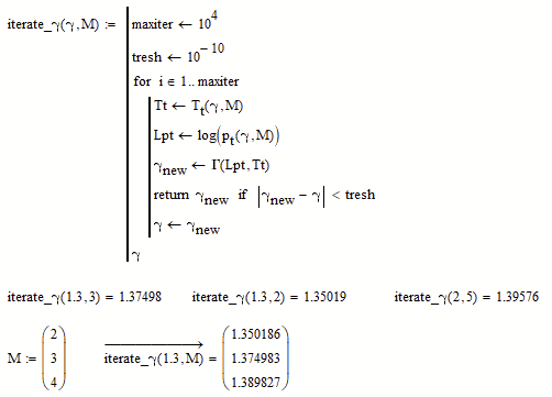

Why not write a function to make the whole iteration and then later call that function vectorized!
When calling the function with a vector M, the first function argument, the initial value for gamma, must be either a single scalar (as the 1.3 in the example above) or a vector the same size of M (so every value in M has its own initial gamma value).
Instead of returning gamma in the last program line (which is only executed when after maxiter iterations there still no satisfyíng value was found) you may consider returning a string which says something about the calculation not converging or replace that line with an appropriate error(..) statement.
