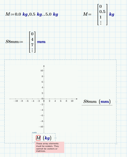

Trying to plot a spring constant after measuring deformation due to applied weight
Why is this scatterplot not working?
Both M and S8mm have 10 values
5 REPLIES 5
Raiko
(To:SS_10582647)
the issue here is that M may appear as if it's a matrix, but it is not. It is a range variable. To correct this issue:
  1. define a one columns matrix of the same length as S8mm called M
  2. fill in the values for M manually
  3. plot them
This should work

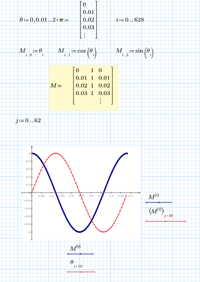

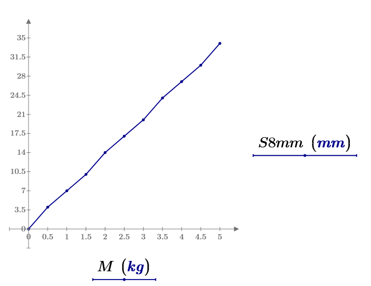

OK this works but what if I need to plot 100's of points? is there a way to convert a range to a matrix?
Raiko
(To:SS_10582647)

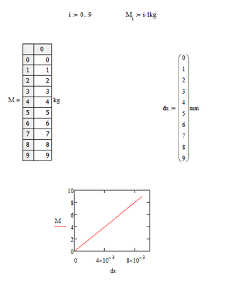

You can always multiply the range variable with a constant; say 1. The result is a matrix then; see attached image.
How to convert a range to a matrix is here.
Using matrix index, we can plot 10*j data only.
