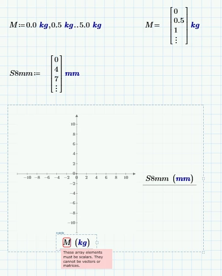

Trying to plot a spring constant after measuring deformation due to applied weight
Why is this scatterplot not working?
Both M and S8mm have 10 values

the issue here is that M may appear as if it's a matrix, but it is not. It is a range variable. To correct this issue:
  1. define a one columns matrix of the same length as S8mm called M
  2. fill in the values for M manually
  3. plot them
This should work

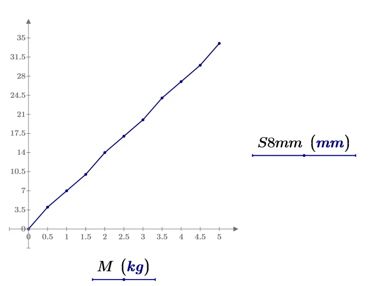

You can always multiply the range variable with a constant; say 1. The result is a matrix then; see attached image.
