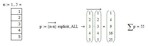

Hello Guys.
I'm a Rookie in Mathcad and is only using it to simple calculations. I Need help with a probadly simple multiplication.
In the picture I made a simplified visulisation of the problem. Instead of adding all the numbers to get 14 I need the facit to come out as a Matrix like:
1*1=1
2*2=4
3*3=9
Is that possible ??

I am not sure what exactly you are after - a table, the total sum or what else?

Use the vectorize operator:
