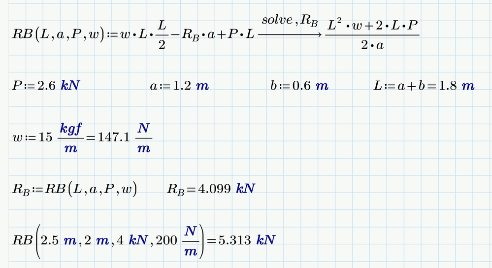

Here as an example how to use the symbolic engine for symbolic results.
The symbolic is used either before the variables are defined or you use clear.sym(...) to make the variables unknown to the symbolics.
You let the symbolic engine symbolically solve for R.B and assign the result to a function with all needed variables as arguments.
Now you can use this function to calculate R.B for different sets of input values
