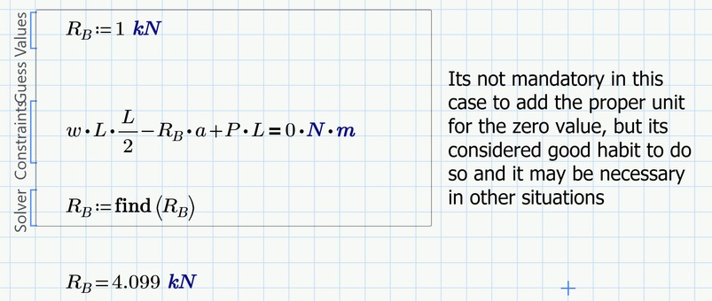

In the attached spreadsheet I can't seem to use the solve function to find RB with predefined variables in the equation. If I manually input all the variables into the equation the solve function works but if I leave it as I have it, it does not.
Am I doing something wrong or can you just not use pre-defined variables?

For numeric result its better to use Primes native numeric methods. These are a solve block with "find" or the "root" function.
You can use the root function in two ways - either provide a range within the solution should be found (I show this for R.B) or you provide a guess value (as shown for R.A).
I usually prefer the root function over the solve block because a solve block looks ugly and unnatural and takes up a lot of space. I use a solve block with "find" if there are additional constraints which have to be considered.
Nonetheless here a solve block for R.B (you must always provide a start/guess value)
