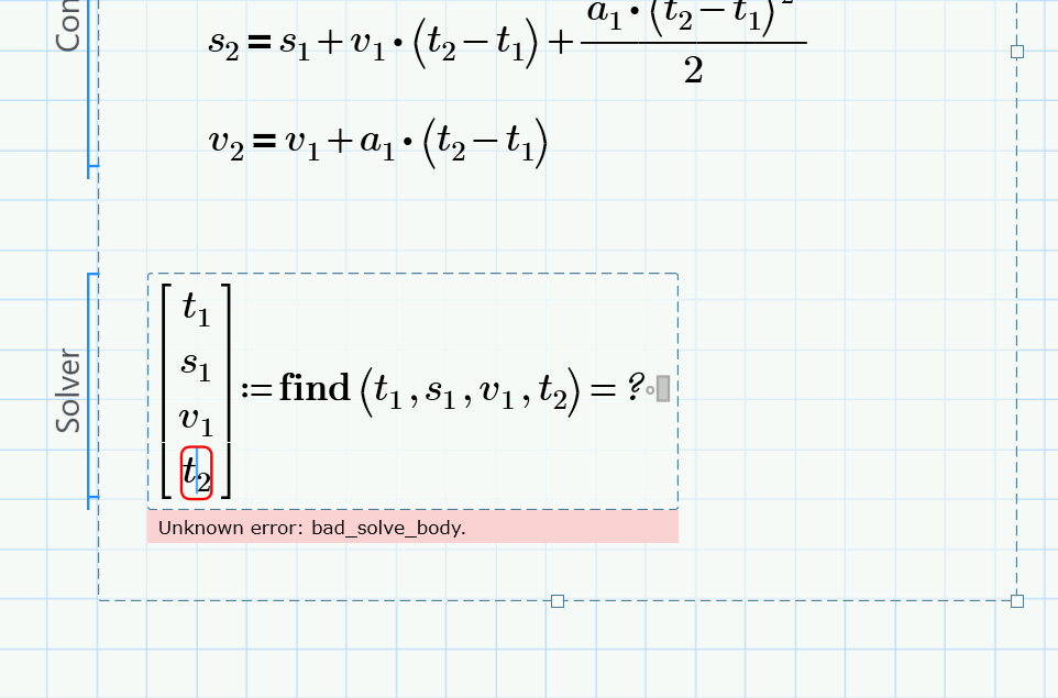

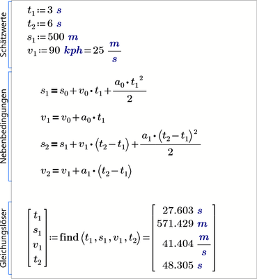

My students and I use Mathcad to solve problems of dynamics. My students this year (prime 10.0.0.0) come sometimes across an unknown error when using a solve block. The error mentions "bad solve block"; refer also to the screenshot. I have never come across it before and I have no clue what the reason could be for this error.
After retyping the equtions and the "find" command, the solve block executes correctly. But I don't see a difference between the original solve block and the one after retyping it. So it stays a mistery why one time it executes and the other time it doesn't.

Are you sure that the equations are correct?
I notice that you defined t.0 and a.2 but they are never used.

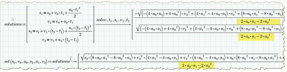

Solving the system symbolically shows that you run into troubles (division by zero) if a.0 = a.1

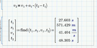

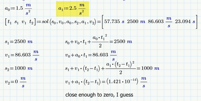

Here I changed a.1 from 1.5 to 2.5 m/s^2 and the symbolics seem to provide a valid solution:
Unfortunately the numeric solve block still fails 😞

Ahhh! Seems you found a bug in Prime 10, Feel free to report it to official PTC support.
The problem is the inline evaluation in the definition of the guess value for v.1.
Delete it (and evaluate in a separate region if necessary) and the solve block works OK - at least if a.0 and a.1 are different!

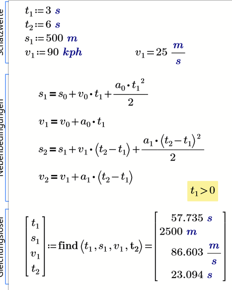

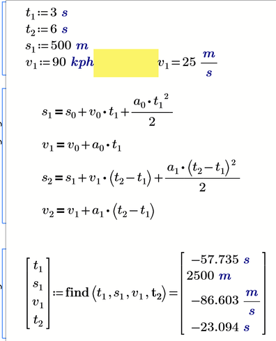

As we have seen from the symbolic solution, there are two sets of solutions stemming from the underlying quadratic equations. In the solve block above we got the (presumably undesired) solution which includes negative values.
To get the other set of solutions you may either provide better guess values (even t.1:=9s will do the job with the values given) or you add additional constraints, for example t.1>0

Hi Werner
Thanks a lot for your comments!

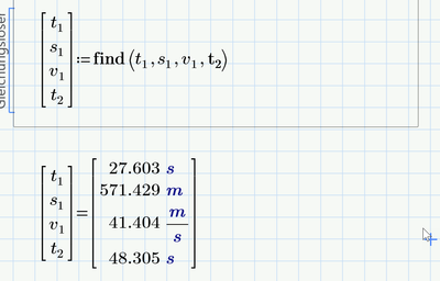

  • you are right, the value for a.1 should be -2 m/s² (mistake in the file of student); but that still doesn't solve the bad solve body
  • indeed deleting the inline evaluation of v.1 makes the difference and the solve block executes
  • interesting is that after executing the solve block and then adding the inline evaluation of v.1 is no longer a problem for Mathcad. I understand that Mathcad has some "rules" of how to enter values and commands, but this is then something I wouldn't expect. Moreover, teaching/encouraging students to use Mathcad (oh yes, they are reluctant!) is more easy if you can "explain everything"... 🙂
But many thanks! I can tell my students not to do the inline evaluation in a Solve block.
