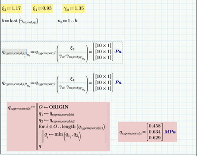

Just one question about ( min function) why it works only with scalars ... whenever I want to use it with vectors or matrics  it doesn't work ...
How to overcome this ?
Should I always use programming ?
For example the following program : in each (qc;gem;cor ) I have 3 matrics each one has ten values.... what I need is to write a program that will compare the both variables and choose the minimum value of each one ( compare the first raw with the first raw  and chooses the min ...and so on  ) ...and the result should be also one matric with ten values. However, it chooses only the minimum value of each matrics

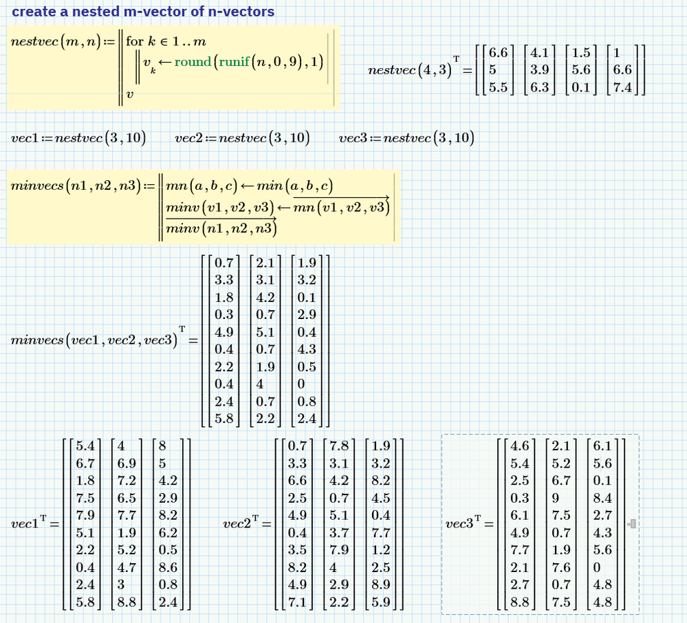

It seems to me that @YA_10963798  would need you function but for only two inputs.
Applied to the simpler example posted in the other thread this would mean
BTW, I seem not to grasp the necessity of your local function minv?

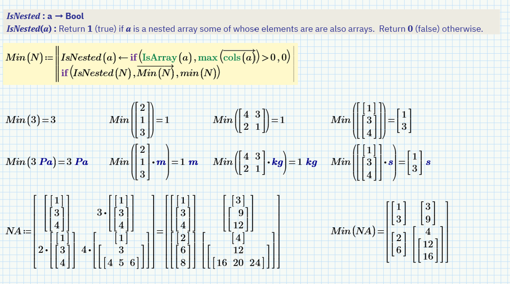

Try something like the function Min shown below.  It recursively calculates the minimum of each nested array ... well, it's supposed to!
The last one is messy but interesting.
Stuart

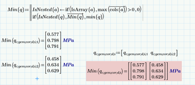

Hi Stuart,
I tried it
Actually what I need is something different I need the program to compare qc;gem;1 and qc;gem;2 and choose the minimum between both of them.
So , it goes to the first raw in both variables and choose the min and then goes to the second one and does the same.
but what we did is just choose the min value in each matric

Ah, my apologies.  I was distracted by another problem and didn't read your message correctly.  I just caught sight of the word "minimum", saw a nested vector, and ran off like a dumb dog chasing a rabbit instead of a hare (not that a modern, socially aware. dog ought to be chasing any fellow creatures, of course).
Is this any better?
Stuart
Prime 9 sheet attached.

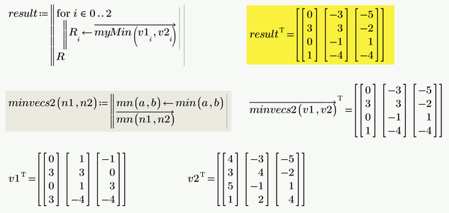

Probably due to sheer laziness on my part.  You've externally defined and vectorized minv (as minvecs2) whereas I put it inside minvecs; AFAICT, it's needed either way.  The lazy way means minvecs is self-contained and I don't need to remember to vectorize minvec2 or, worse, potentially vectorize it more than once!! 😱 I have a self-imposed per diem keystroke limit - my personal contribution to saving energy and reducing anthropogenic global warming.  😇
Then again, I might very well have missed something that you've spotted and am still failing to see it.  ☹️
Stuart
I've miscopied vectorized expressions more than once because I didn't fully enclose the expression, so I tend to avoid explicit vectorization, preferring to hide it away in a function where possible.
(To:StuartBruff)
Ahh, I missed the fact that in your version its not necessary to vectorize the function call when used with vector arguments.
Usually I prefer to explicitly vectorize when I call a function with vector elements and want the operation to be done element-wise - not least to remind myself of what is happening at that point. But now I feel guilty of being more responsible for global warming than is absolutely necessary 😞
And besides global warming effects, a function which is written to take vectors as its input and apply the vectorization itself sure has the benefit that the function calls look less ugly and confusing as of the arrow above them.

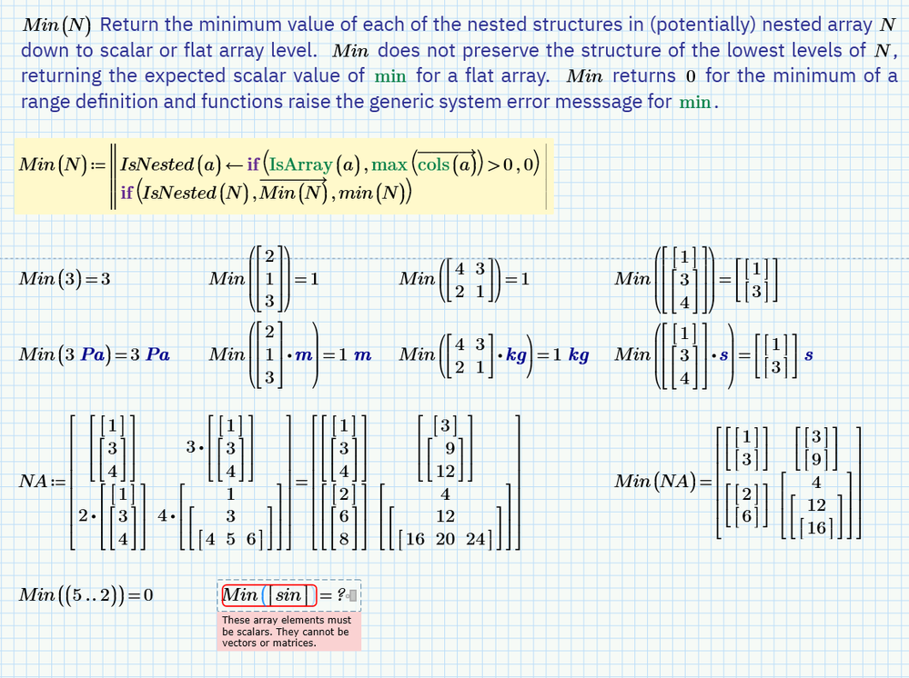

Here's an example of making things more complex but with added generality of function.   Which output would people prefer, if either?  And which would they like to see as a solution to their specific problem?  Note: structure-preserving means that the overall shape of the nested array is preserved, ie the fact that an element was an array or not an array. It does not preserve the size of the nested elements, nor should it, as min is a reducing function.
The first variant of Min could be readily made into a structure-preserving function by copying over the last line in the function body of the second variant.

(To:StuartBruff)
I like it, but I am not sure if many people would expect a 1x1 matrix as the result of a vector or matrix argument.
But of course that is what structure preserving means.
Nonetheless I'm sure that some people would prefer
But then, its all a matter of what you need the function/result for in the further calculation.
Its similar to match or lookup, where you often just need the index number or the matching element and not a 1x1^matrix, which is returned by the built-in functions. They do this for good reason, as there could be more than one match and it would complicate a lot of applications if the functions would return a scalar instead if a 1x1 matrix.
