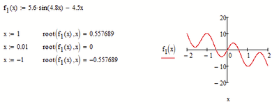

I would advise against using the symbolic "solve". In case of your first function it would return only the trivial solution x=0.
Using one of the numeric methods you get the other two solutions as well if you provide appropriate guess values.

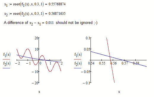

I take it you are looking for one solution where both cross the "X" axis at the same point .
??? There is no such 'solution' !!
0.55768... is not the same as 0.56871....
I guess you may be able to even see it in your plot if you zoom in enough.

@ppal wrote:
Depends on your tolerance settings -
No, it depends on the math and the two zeros are close, but they are definitely different. In other words - the graphs of the two functions have a couple of common points but none of them lies exactly on the x-axis.
The default tolerance setting (10^-3) is all thats necessary to get the two different solutions mentioned.

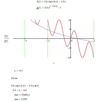

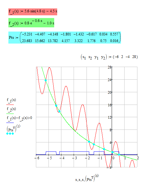

Guessing,  maybe it is this :
