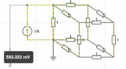

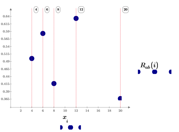

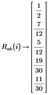

R(4)=1/2, R(6)=7/12. How about R(8), R(12) and R(20)?

Resistance of one resistor branch by Mathcad.

Yes, all resistances of each branch is 1 ohm as shown in my picture. The question is the eqivarent registane of one branch of the regular polyhedrons such as regular tetrahedron=1/2 as shown in my question.

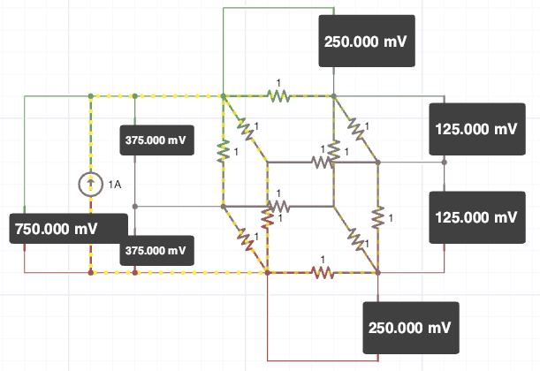

Thanks. Your case is a diagonal resistance of regular polyhedron surface.
Regular hexahedron shows 3/4 ohm. I am using current generator of 1 A.
So V=IR =R shows the resistance itself.
