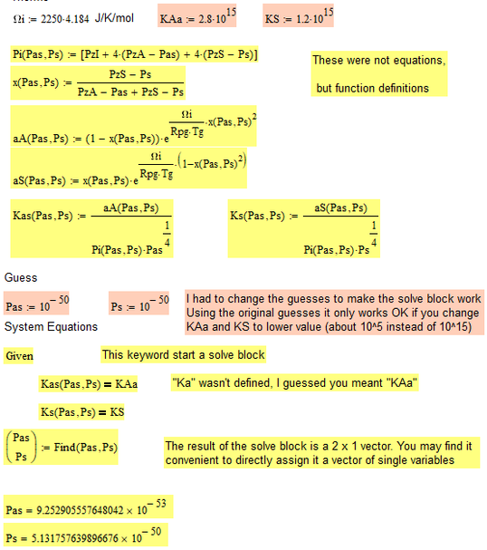

Hello All,
    I am struggling to find the proper code for solving a system of non linear equations, using Mathcad 15.

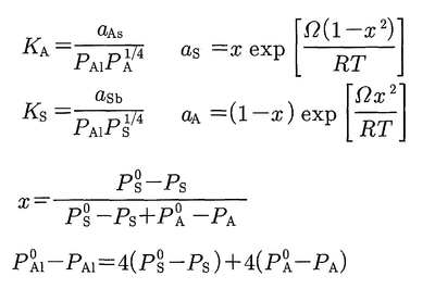

    The equation are given in the screenshot below. The problem is related to thermodynamics.
    I followed a template with Find, however it just don't get me anywhere.
    What needs to be done to get the results ? Can someone explain the issue (for the layman).

System of equations
     Result sough PA (Pas in code) and PS (Ps in code).
     Once PA and PS are available; related parameters "aS", "aA" (aA and aS in code) and x calculations are straightforward.

Basically the problem was wrong syntax for the solve block and that you wrote your function definitions as if they were equations.
But using your values and equations the solve block could not find a solution. Either use much lower guess values or change other values (as written in the file) or maybe have a second look at your functions to see if there is something wrong with them.
15 REPLIES 15
File enclosed you will need to check the equations and values as it does not solve properly.
You only need two equations for two unknowns.  You need a "Given" statement to start the solve block.

Here is my attempt for a solution.
Thank you. That's really great. I was worried by the 0 values from the previous post.

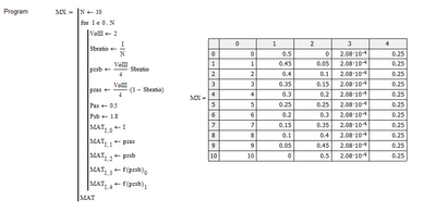

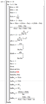

This time, I am looking to nest the resolution into a loop as one of the aim of the exercise is to to plot one input value to an output (mole fraction in gas vs. mole fraction in solid).
How it's done exactly ? I can't see how find is used with programming code.
Pierre
Mathcad 15 programming
You can't use a solve block in a program.
But you can turn the solve block into a function of the values you would like to change and use that function in your program.
Simply close the solve block with f(..,..,..) := Find (Pas,Psb) and use function f in your program.

I got a function that seemed working at first glance, but actually all the output values are the same (column 3 and 4), what's wrong. What's wrong  ?
Thanks for the help,
Pierre
Two different inputs with same output.
A looping attempt. Notice identical values in column 3 and 4.

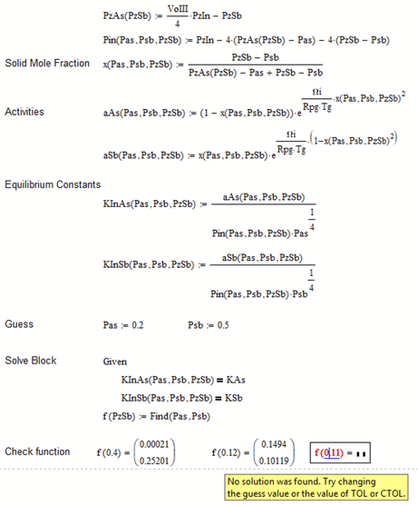

The formal argument of your function f (PzSb) is never used in the calculation/solve block. So do you think it would influence the result?
If you define
x:=5
a:=2
b:=3+x
f(x):=a+b
you should not be surprised that f returns the same value (10) regardless of the actual argument passed because the calculation of b uses x=5 all the time.
Apart from setting up the problem in a different way you can solve this by making b a function of x:
[no need for defining x:=5]
a:=2
b(x):=3+x
f(x):=a+b(x)
A similar approach has to be taken in your sheet. So far it uses PzSB=0.4 for every call of f.
The solution is to turn every calculation which uses PzSb into a function of PzSb.

I gave it a try but unfortunately the solve block will not find a solution for values of PzSb smaller than 0.12
You may wrap a second function around f which returns NaNs in case of the solve block failing. That way you could use the function in your program with the loop and see, for which values it fails.
