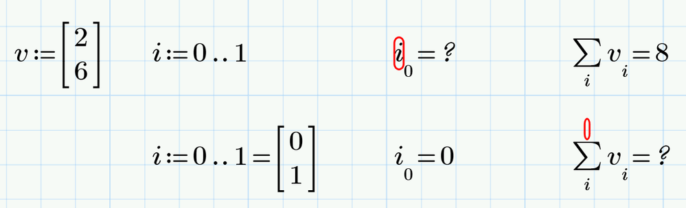

Sum in Mathcad Prime
ValeryOchkov
Is it an error in Mathcad Prime?
14 REPLIES 14
Odd, Valery.  It seemed to work on my Prime 7.0.0.0 Trial.
Stuart
LucMeekes
(To:StuartBruff)
Stuart,
Not odd. The 'magic' is in the fact that Valery put an evaluation (=) after the range definition of i. That changes the range to a vector. This is a special feature of Prime.
With that evaluation your sheet shows:
The summation with a single i at its bottom, requires i to be a range; vector is not allowed.

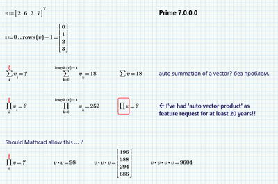

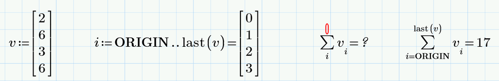

StuartBruff
(To:LucMeekes)
@LucMeekes wrote:
Stuart,
Ah, of course.  Thanks, Luc.  I definitely need those new glasses!
I did know about this "feature", but I tend to avoid putting evaluation operators at the end of definitions, precisely because of such side effects.   I don't think that it's entirely clear from the rhs of the evaluation what the definition will actually assign to the variable.
IMO, for this purpose, they'd have been better off implementing a vec function that converts any argument to a vector.
I believe that I've suggested in the past that Mathcad ought to auto-iterate over vectors (or arrays, in general) in such cases.   I vaguely recall having a discussion about this some time ago and there being some objections - but I can't remember what they were.  I'll have to have a think about it.  I vaguely recall Tom Gutman and jMG commenting ...
However, the feature request for an automatic vector product still stands.  🙂
Cheers,
Stuart
(I also wonder if min and max ought to return the first and last elements of a range ...I can think of a few uses for this capability?)

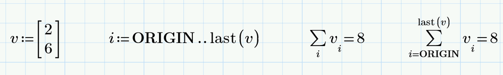

"I did know about this "feature",":
It's not a feature. The evaluation of a range turning it into a vector is not on the published list of methods to create a vector (See Prime Help under: Vectors, Matrices, and Tables > Creating Arrays and Tables > Methods for Defining Arrays), so it's an undocumented side effect that creates problems for users.
"I tend to avoid putting evaluation operators at the end of definitions" :
I fully agree, it is a common source of problems, occasionally seen here on the forum.
"I also wonder if min and max ought to return the first and last elements of a range ...":
No, certainly not. min() and max() serve to get the lowest and highest values of an array (vector or matrix). Those are not necessarily the first and the last respectively. To get the first of a vector V you simply use V[ORIGIN and the last is had with V[last(V).
Now if last() wasn't already used to get the highest index of a Vector, I might have advocated the functions first() and last() for those element values, but alas...

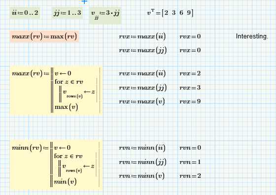

Whilst noting Luc's ( @LucMeekes ) comments below, I thought I'd revisit the notion of min and max applied to a range, and added the string type so it didn't feel left out.  I've used the MP11 built-in function vec to handle the conversion from range to vector, rather than the previous iteration over the range.
Of note is that the max and min values given for a range are not the start and end values of the range, but, rather, the minimum and maximum values of the expanded range (which might not include the end value).
And a slight addendum to handle nested arrays.
Just food for thought ...

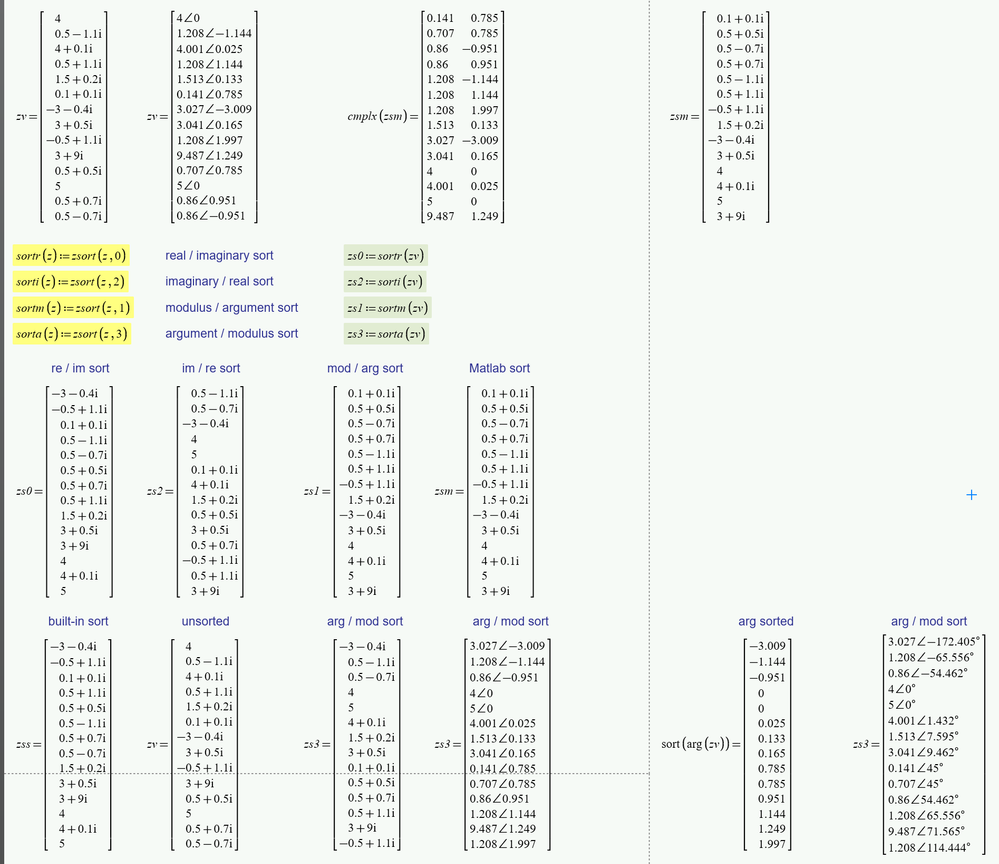

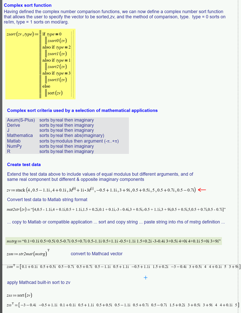

StuartBruff
(To:Werner_E)
I assure you that, as a Brit, I consumed devilish humour along with my first teething rusks.  And being ex-military means that I have to consciously rein it in. 😈
However, dealing with the last bit first, sorting.  AFAIA, Mathcad 11 and Mathcad Prime ignore the imaginary component of a complex number.  I dug out an old M11 mergesort worksheet that allowed me to play with different sorting options.   Naturally, it is broken under Mathcad Prime - I suspect a Boolean shortcut difference is the cause, but I can't see it.   Instead, I've used an alternative approach to provide various options for sorting complex numbers.
(You can tell how old the original worksheet is from the reference to Axum S-Plus!  I haven't posted the worksheet, because it's a bit of a slapdash thing even by my standards, with expressions dumped where I could find a space)
I plugged my all-singing, all-dancing vec into max and min, and that seems to work for some cases of lack of interest.  However, there are couple of more that I need to address, and my current solutions are, at best, 'clumsy', if I'm being charitable.
