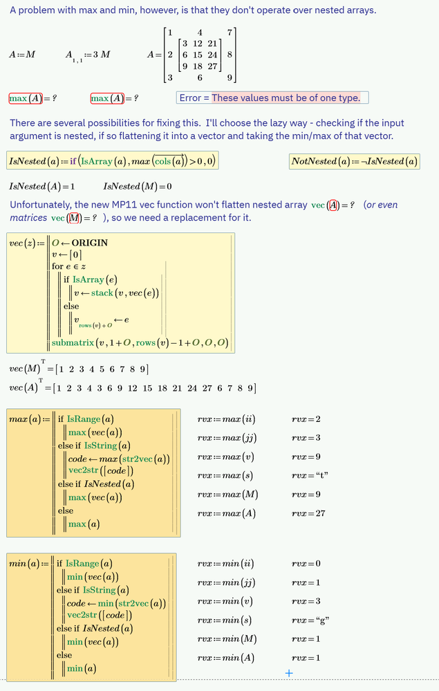

Whilst noting Luc's ( @LucMeekes ) comments below, I thought I'd revisit the notion of min and max applied to a range, and added the string type so it didn't feel left out.  I've used the MP11 built-in function vec to handle the conversion from range to vector, rather than the previous iteration over the range.
Of note is that the max and min values given for a range are not the start and end values of the range, but, rather, the minimum and maximum values of the expanded range (which might not include the end value).
And a slight addendum to handle nested arrays.

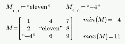

StuartBruff
(To:Werner_E)
Hi Werner,
I was just thinking about posting a version using my range-expanding, nested version of vec. That seemed reasonable, and I’ll add it when I’m next near a computer.
I wasn’t sure, however, about the validity of finding the min & max of an array whose elements are of mixed types (eg, real & complex, or real & string).
Complex numbers don’t have a natural sort order, although I’d be tempted to opt for sorting on real then imaginary rather than modulus then argument.
Strings and traps have several obvious options. First, squawk like a drunk parrot and raise an error (status quo). Second, return separate max and min, NaN for no value if string/number not present. Third, min/max on numbers and character code points. Fourth, min/max on numbers and string representations of numbers (eg, “3” > 2), and the Third option for mother strings. I’m sure there are other possibilities.

(To:StuartBruff)
I was just in the mood to be a little mean. 😉
BTW, I just asked the KI of DeepL to rephrase the above sentence and had chosen 'Academic' style.
One of the proposals was
"The impetus behind this decision was a spontaneous inclination towards inflicting a degree of unpleasantness upon the subject."
Wow! I needed a translation app to understand what it means ....
According the desired results when given mixed numbers and strings I sure don't know what a max or min function actually should return - replace characters by ASCII or UNIcode? Error message, try to interpret the the string like in
Guess the error message given by Prime is good as any. Interesting is that we get different error messages depending on if we mix scalars and ranges or rather scalars and strings. haven't thought about non-real numbers -  already had too much red wine (or as DeepL's KI phrases: "It has been determined that a considerable amount of red wine has already been consumed.") 😉
Well, then .. Cheers!
BTW, Prime's "sort" follows the algorithm you outline - sorting for real parts and only if they are equal consider the imaginary part. Personally I would see more logic (if any) in sorting by magnitude and consider the argument in case of equal magnitude. This would mean that a number is "larger" the further away its from the origin.
