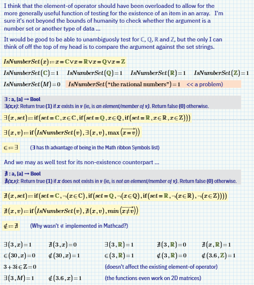

I've just had a quick look at the MathcadPrime 7 documentation and it could do with a spot of editing to clarify which operations can be used with data types and how.
I also don't think the Is Element Of (IEO) operator () should be categorized as a comparison operator; it tests for set membership, not a comparative relation.
Here are some comments on the comparison operators and some suggestions for extending the IEO operator.  Mathcad Express 7 worksheet attached.

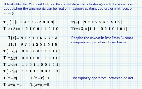

Data values used in the evaluations below:
Brief summary of non-vectorized comparison operations:

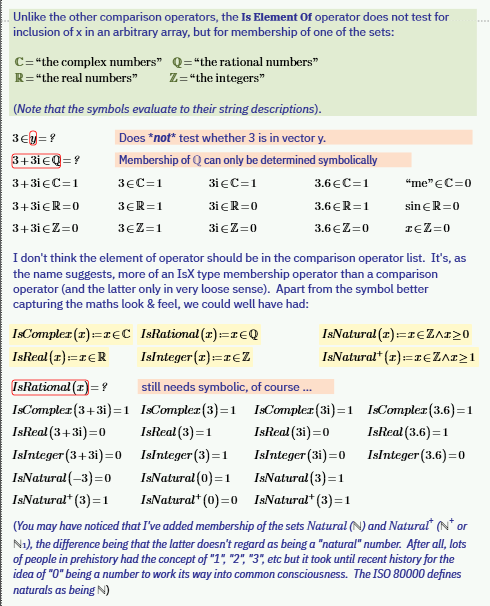

Observations on the IEo operator:
(I've (defined and) used the IsNatural function several times to check for positive integers in worksheets)
Outline of the concept of extending the IEO operator to "normal" data types.

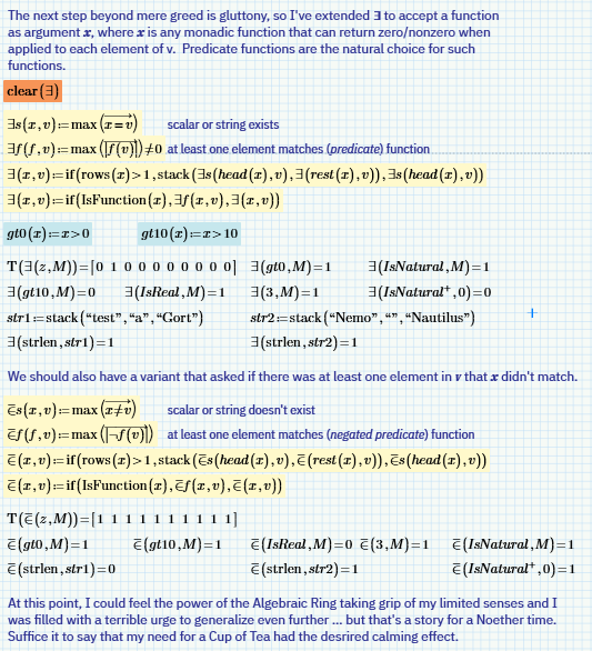

Further extension of the IEO operator to operate over (predicate) function and vector values as the first argument.
I haven't proofread the worksheet, so it's likely full of grammatical and logical errors, but it's just a collection of (slightly rearranged) on-the-fly observations and thoughts.
