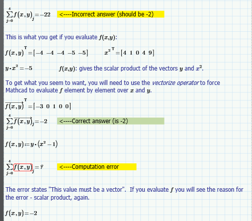

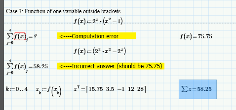

(To:LucMeekes)
Luc,
I came across one more challenge: when there is a function of two arguments such as f(x,y) Mathcad computes incorrect value of the summation. If the function is given with the argument "y" outside brackets, then Mathcad indicates an error in computations. The same issue is when we have a function of one variable which is inside and outside of the brackets.
What do I do wrong here?

StuartBruff
(To:Sergey)
@Sergey wrote:
Luc,
Sergey
Don't forget that Mathcad is an array language, Sergey.  Consequently, if there are vectors or matrices involved, Mathcad will interpret operations as array operations if it can.
What were you expecting f(x) to produce as a value?
Stuart
Prime Express 7 worksheet attached.
Vectorize operator help: https://support.ptc.com/help/mathcad/r7.0/en/index.html#page/PTC_Mathcad_Help%2Fvectorize_operator.html

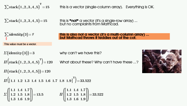

@LucMeekes wrote:
Prime is pretty forgiving. Without requiring a transpose, this also works:
Forgiving, Luc?  Inconsistent more like.
If it were forgiving, I wouldn't have to prettify myself in front of the mirror and put on my best, whiny orc accent ...
Is Saruman reserving them for some amusing fate?
(I wonder when we'll get the prefix operator back?)
Stuart
LucMeekes
(To:StuartBruff)
You're confusing stack with augment?
Not that it matters much:
Sergey
(To:LucMeekes)
So "stuck" is basically another way of representing a vector?
StuartBruff
(To:Sergey)
"stack" is closer to being an array constructor than a representation of a vector.
stack forms an array by joining its arguments together vertically.  These arguments can be of scalars, strings, vectors or more general arrays.  The major restriction is that the arguments must have the same number of columns (scalars and strings get effectively promoted to single-element arrays).
augment is like stack, except that it joins arrays horizontally  - implying that the arguments must have the same number of rows.
Stuart
