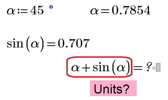

Only if one accepts that an angle *is* just the ratio of two lengths ... which hypothesis somewhat defies the observations of our eyes.
I prefer an alternative hypothesis in which the quantity angle is a base dimension within a system of units. This, to my eyes, makes more physical sense (how else does one capture the physical notion of rotation?).   The maths works out, ... it's just that most people won't like the 'New Units Maths' because it changes how they would do dimensional analysis.
Stuart
Point please second!
radians.
Stuart
(seriously)

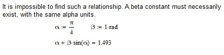

Why do you think there must be a constant?
Stuart
-MFra-
(To:StuartBruff)
It is an example. In general, the individual terms of a polynomial (linear and non-linear), if they are dimensionless, everything is ok. But if one of them has units of measurement (for example the rad), then there must be homogeneity between the various terms (this is obvious). So if alpha is in radians and is added to something, this something must also be in radians (this too is obvious) and since sin (alpha) is dimensionless, it must necessarily be multiplied by a constant or a variable ( with the same dimension as alpha) which makes the term homogeneous with the others. Another example is the following relating to a differential equation:
StuartBruff
(To:-MFra-)
Agreed.
Also agreed.
But here's where we probably diverge.  Why do you think that sin(alpha) is dimensionless?

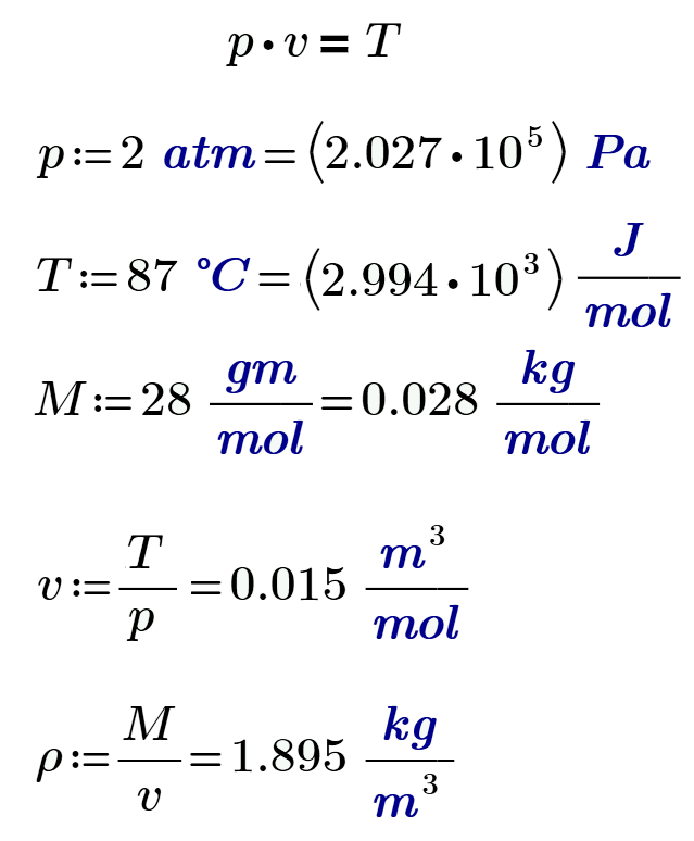

Sorry but the state equation of perfect gases is: PV = nRT. So it is not clear to me what you write.
Sorry the state equation of perfect gases is pV=T.
R is a coefficient between J/mole (a base unit of temperature) to K (one others unit of temperature).
