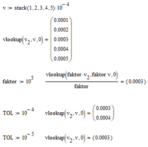

Hallo,
i have a special problem. My sverweis function is not working properly. Sverweis gives more results than realy exists it should only be 2 results. 152 is no valid result. I added a Paint Picture of my special problem.
I need to know the loadcase of the maximum damage (<1 for each)
Thank you,
BR Stefan

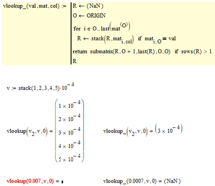

I'd prefer to write my own match or vlookup routines like this:

Maybe we should translate for other readers here:
erweitern -> augment
sverweis -> vlookup
You experience a simple effect of bad precision. Match and the various lookup command only look within a certain precision and nor for an exact match. You may try if setting TOL to a lower value than the default 10^-3 would help but otherwise I guess there is no solution other than to write your own lookup routines.
One additional idea: You may try to replace sverweis(a,b,2) by something like sverweis(10^8*a, 10^8*b, 2) and see if it helps.
Here are examples of those workarounds:
I dotn understand why is there a workaround required im searching the same value out of a matrix which contains that same value? Why are there coming wrong values? Im still confused. So does sverweis only consider the first 3 digits after the comma for comparison? What is the TOL value? Where do i change that value?

Fulfillment of boundary conditions are crucial to me. Is there a way to avoid this? If x<2 than 2,001 is not ok and 2 is also not ok and 2*10-5 is also not OK to me.
Il try your suggests and will see if that works.
What are the lowest TOL and CTOL values?
Thank you br Stefan
(To:sm�ller-2)
It should - see the screenshot of an example in my reply above.
Mathcad uses IEEE format for storing it numbers which usually is good for a precision up to 15 or 16 decimals. So obviously it does not make much sense to set values lower than 10^-15.
Setting TOL (CTOL does not affect the precision in your case) may influence other calculations in your sheet (a numerical integral or a solve block may fail to converge if TOL or CTOL is too low). So you will have to balance the value of TOL in a way your sheet is still working OK.
The variant with the faktor may be a better alternative even though it means more typing and worse readability.
You are my man 😃
Thank you!
