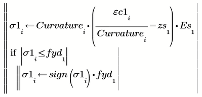

Whether I want to obtain a symbolic result with a condition that contains the desired variable, can this be realised somehow in Prime?
It is crucial because if my symbolically derived value of epsilon_c2 leads the highlighted equation to a value greater than f_yd, it must be readjusted. ( I hope the SOLVE block will give me the chance to eliminate iterations with WHILE and FOR loops...😒
Sorry for annoying you. Knowing that I almost got to the point of resolving the issue, but embedding my condition in compliance with Mathcad syntax is hardcore...It really makes me crazy.
Maybe there are more tricky methods to get the correct value of epsilon_c2 that satisfies the condition???

The symbolic tries to evaluate the expression symbolically which means without knowing concrete values. Therefore branches and other conditions can't be evaluated.
The second argument ec2 in your function N() makes no sense as ec2 is the variable you are solving for.
Instead of your if..else.. you could use the "min" function, but this will not help with the symbolics.
I have not followed the complete thread and I have no expertise whatsoever in your field of work, but I wonder why you would use the symbolic solve.
You could use the root function. Your function N() seems to have a pole at ec2=ec1 (N-> inf) so I assume that you are looking for an ec2 > ec1.
One way to use the root function without a guess value would be that way:
Given your value of ec1 we get
I don't know what you intend to do with a function which returns ec2 depending on ec1 and I am not sure which values of ec1 you intend to feed into this function. I noticed that my attempt fails for values of ec1 larger than approx. 0.006393.
I have not investigated further, why, but it looks to me that there simply is no solution for larger value of ec1.

It looks like you could replace
with
or at least you could use
if sigma is not negative in all cases.
I also noticed that  Es and fyd are 2x1 vectors with both values identical and you are just using the element with index 1. Any reason for defining these variables as vectors? Similar with As, where you also use just the first entry.
