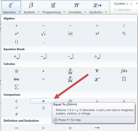

i <- 0 is a local assignment!
In a conditional you have to use the comparison equal (Boolean equal)
See modifications in attached sheet.
If you just wanted all values to be zero in front it would have been easier to work from the previous sheet and simple add the zero values on top 😉
