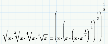

I have the following query: I need to symbolically simplify the following function.

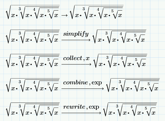

Using the following operators that I know of, I do not get a simplified answer:
Writing the function exponentially, I also do not get a correct answer:

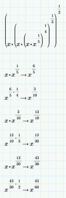

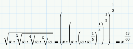

Working in parts if I get the answer:

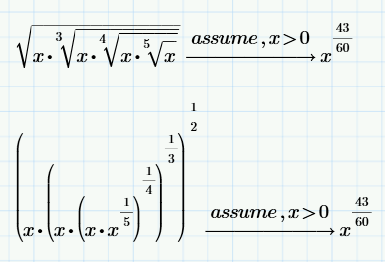

First realize that it is hard to control the output of the symbolic processor of Mathcad (and Prime) exactly to one's desire.
Here's my result in Mathcad 11 (with Maple)....Not so easy, maybe you have more luck in Prime when you assume that x > 0:

Thanks for your solution Luc. Working with Mathcad Prime I get what I was looking for:
