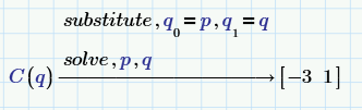

What does work is:
and this:
To have it a little bit more nice-looking, replace the indexes with literal subscripts:

What does work is:
and this:

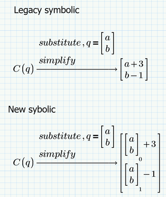

(To:LucMeekes)

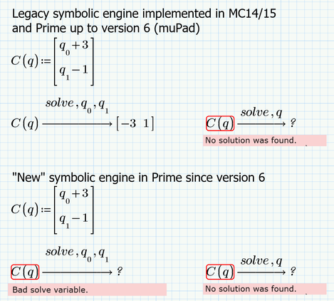

In Prime 6 we can compare the old and the new symbolic engine. Obviously this is one  more thing which got broken when switching from muPad to the new axiom fork.
As I read here in the forum, PTC claims that the symbolics in Prime 8 is vastly improved and more stable. So far I could not be bothered to download and install P8 but I guess Luc's attempts were done in P8 and the problem still persists.
Here is the comparison:
Needless to say that because of Primes sever auto-label bug it was necessary to manually re-label all occurrences of "q" the same.

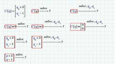

Here is another finding which might give a clue why the new engine fails:
