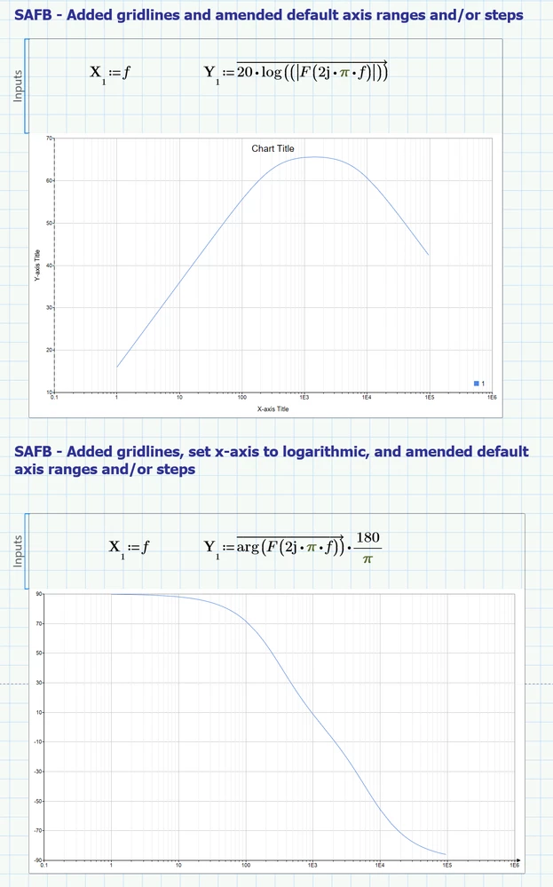

It took me a couple of seconds to work out why Tetsuro's phase plot looks different to yours - it's the linear vs logarithmic x-axis.
To add my minor tuppence worth, I've modified your phase plot, removed the symbols, and added gridlines (I believe they're normally shown in Bode Plots?). I didn't necessarily like the auto-scale's choice of min/max values and steps, either.
Stuart
Your function would return all non-real results which can't be plotted, like
You type a square bracket and this creates a matrix - guess this was not your intention.
Maybe you meant it to be the absolute value? Then of course you also would get real results.
But because f is a vector, you will also use vectorization as otherwise only the absolute value of the vector would be the only single scalar value.
Vectorization is also what you need in your second plot
P10 file attached
Correct. All I edited was the vectorization and I left the original of @FC_10037391 otherwise unchanged. Actually I avoid opening the chart component because its so slow and awkward to use.
@Werner_E wrote:
OK. That explains that.
I don't recall using the chart component before, but never has a truer word been spoken, Werner. Even the Aesop's hare got past the finishing post first and he'd had a very long sleep in the gentle warmth of the CPU.
