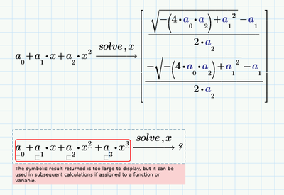

I'm afraid the value has to be increased to ridiculously large values, considering:
results in:
And I've increased it by a factor of 1000 and still no result from the cubic solve.
(Not in Prime 7, nor in Prime 8.)

Incidentally, for those interested in what the solution might look like:
