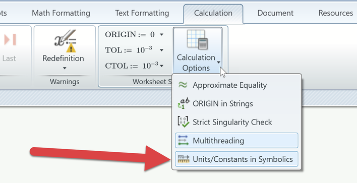

Maybe it helps to turn on units/constants in symbolics and let the sheet recalculate.
Otherwise I second what Terry had said - post the worksheets, not just pictures.
