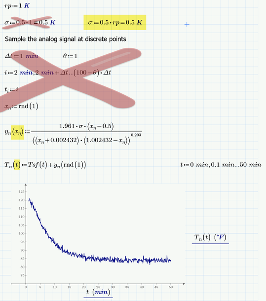

 In scenario 4, I got everything correctly. However, when I tried to graph the plot. There were an issue with "too many range variables".

You still have the wrong definition of sigma! You compare 0.5*1 with 0.5K and the result is zero (because they are not equal) and this zero is assigned sigma. Your sigma is zero! Give it a try. Furthermore in the definition of y.n you used sigma as if it were a function.
And the way you defined and used x.n your "noisy" signal would have used the very same random number for every time - not very noisy 😉
Here is a way to do it. Do you really mean T.n to be 0 (zero what - K, °F, Delta°F,..?) for times smaller than 2 minutes? You may replace the 0 by NaN (which suppresses plotting) or by Tsf(2 min).

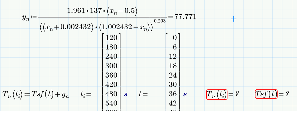

Do you have any recommendation for this? 😞 The Tsf was calculated in scenario 3. I'm not sure why the Tn(ti) doesn't work

Sigma unit is K so yn is also K. I have added the unit to K and Tn(i) still doesnt work. It probably because of my the function or something.

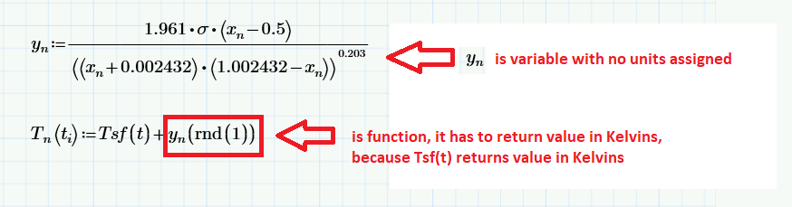

you must define yn as function !!!

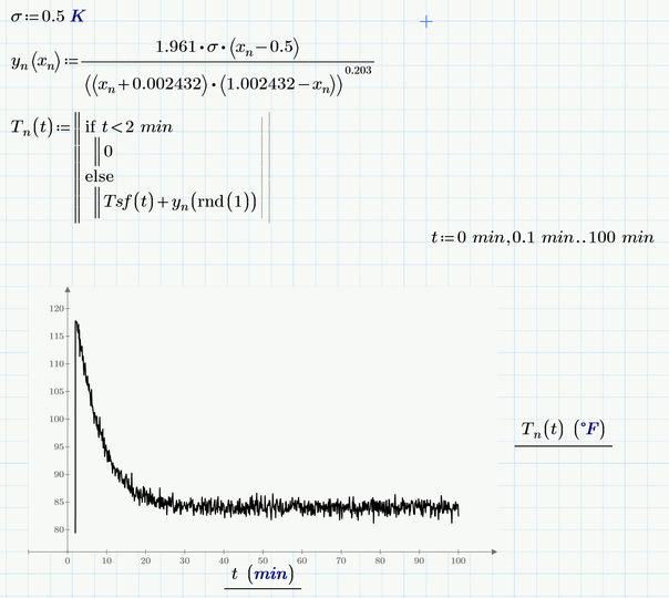

Looking for something like this?
it looks really good. But the Tn is T noise so it would start at 2 and the time interval is ti = 2,3...99. I have some new updated here.

Got it. I'm working on it again now. I mean at Tn won't generate the first signal at 2mins. so from 0-2 mins, Tsf is the actual sensor temperature (Tsf).
I think the issue here is t(time) range, because the Tn will send the mixed signal at t=2min while Tsf start at 1min. I also attached the picture that I supposed ti generate
Thank you so much
i GOT ITTTTTT. We just need to graph this with ti not t. yayayayayayayya
