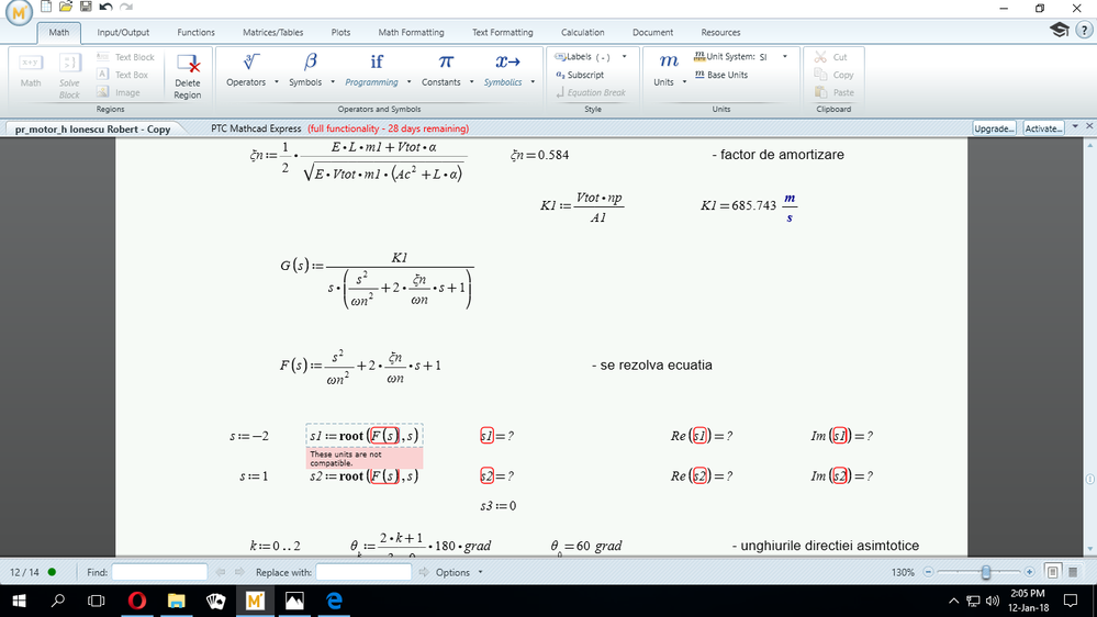

These units are not compatible
Cetinash
2-Explorer
3 REPLIES 3
LucMeekes
(To:Cetinash)
Try, instead of setting s:=-2 (without units), to give the guess value for s the same unit as what you give ohmega.n.

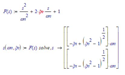

Otherwise, first solve the system symbolically, then fill in the values.
(To:Cetinash)
We don't see the value of wn.
What you have written should work if wn is unitless.
Otherwise  s and wn must have the same unit and the guess value s:=-2 must have this unit, too.
