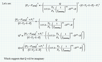

We don't need no stinking solve block!

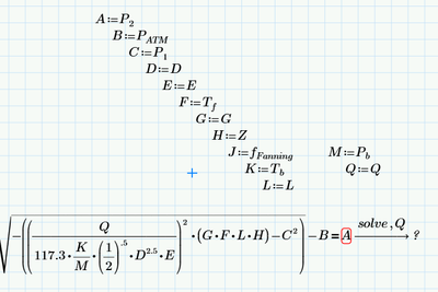

For refrence, this is my other attempt that I know is in the wrong direction but if it helps anyone:

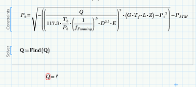

Third attempt is getting closer to what I want  but unsure if it is exactly what I want...sorry for the spam but this problem is urgent for me.

In your first attempt using a numerical solve block you might have forgotten that you need to define a first guess value for Q.
In the second attempt using the symbolic solve it might be a problem with Primes infamous auto-label feature. Can tell by just seeing the picture, though.
EDIT: Haven't seen Fred's response at first. If Q is not real valued, the solve block does not find an answer if the guess value is real. So you would have to use a guess like Q:=1i
