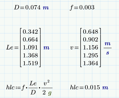

I am having an issue where I can't get a range of values when I use two ranges in one equation:
for hlc I am expecting a range similar to Le and v, what am I doing wrong?

The auxiliary variable T should not be necessary.
Simply vectorize the whole expression on the right hand side of hlc:=... in your original sheet.
What you have are not called ranged but vectors.
Actually the square of a vector (v^2) is not defined from a mathematical point of view. Its NOT v*v (which would be a scalar).
Instead of throwing an error Mathcad applies implicit vectorization, squaring each element of the vector and collects the result in a new vector.
Now your formula demands Prime to multiply two vectors, Le and the newly created v^2. Prime does as demanded and gives you back the vector product, which of course is just a single scalar.
You had in mind to multiply each element of the one vector by the corresponding one of the other and this is exactly what vectorization is made for.

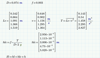

I found a way of doing it (typically right after I posted here), it's not the neatest solution but I used vectorization to multiply the two and put that into a single variable, then used that variable in my equation instead:

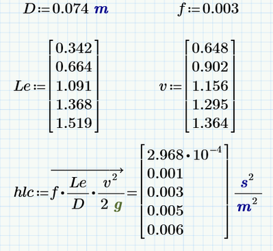

This can be done as a single step by using the vectorize  operator Ctrl+Shift+^ or from the Math>Operators menu.

Isn't this exactly what I suggested in my answer above when I wrote
"Simply vectorize the whole expression on the right hand side of hlc:=..."
