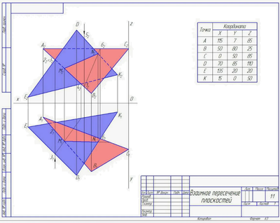

When I was a student, we solved the following problem in a class on descriptive geometry (now it’s engineering graphics). There are two triangles in three-dimensional space. Triangles intersect. You need to draw triangles in stereometry and in three projections. The triangles are colored - one red and the other blue. It is also necessary to draw a segment of their intersection.
Can this be done in Mathcad? Better than 15th.
I hope someone will enjoy solving this problem. And remember your student youth.

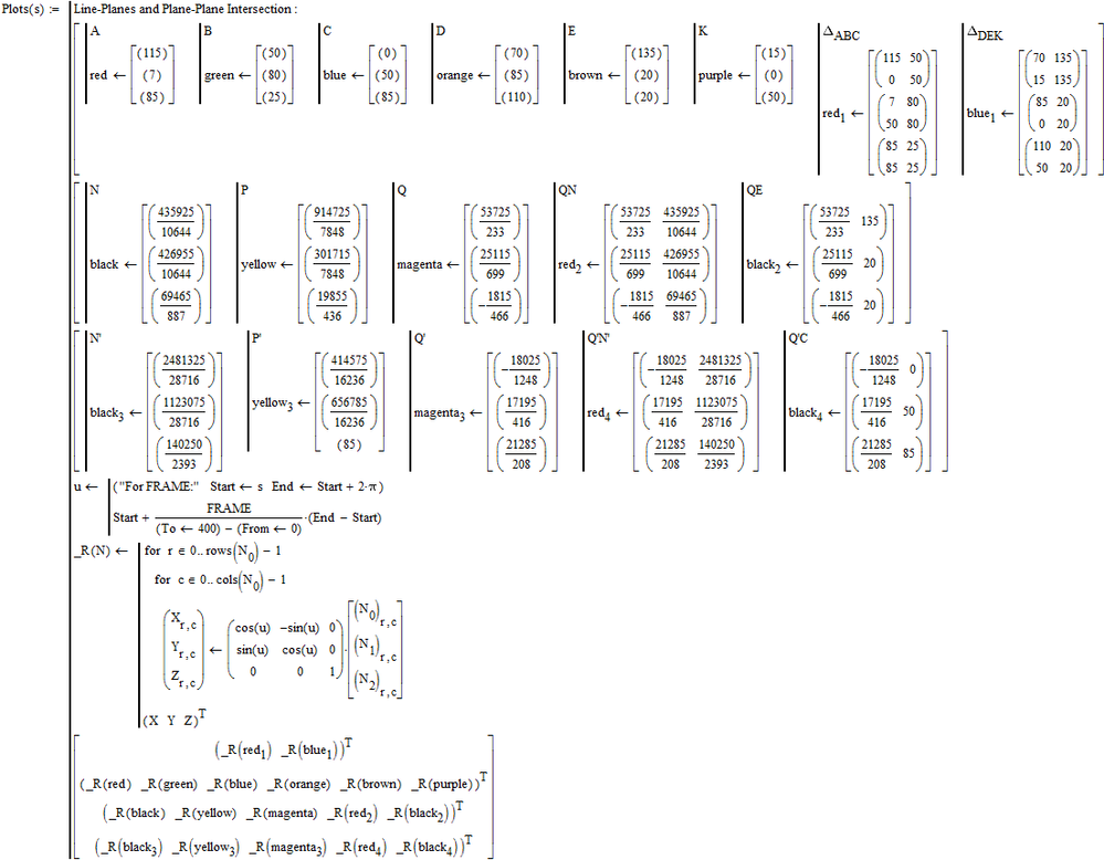

   I'm a new with this intersection line and spend a whole day to deal with, Ttokoro :
00. Two Triangles.avi

         Regards.

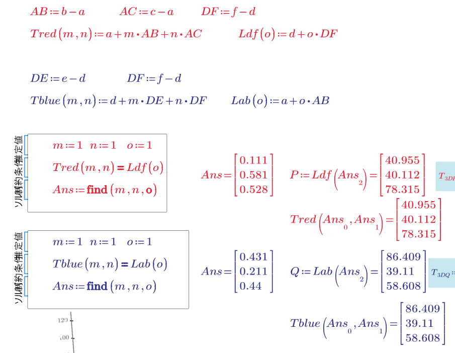

      I use solveblock's find to solve the intersection of plane and line.
      I fear we are repeating ourselves in the topics we are dealing with ...
      https://community.ptc.com/t5/Mathcad/How-to-plot-a-triangle-of-XY-plane-in-3-D-for-SURFACE-PLOT-TO/m-p/695209/highlight/true#M192636
      Adding the points and line of intersection should not be that big a problem for any of us.

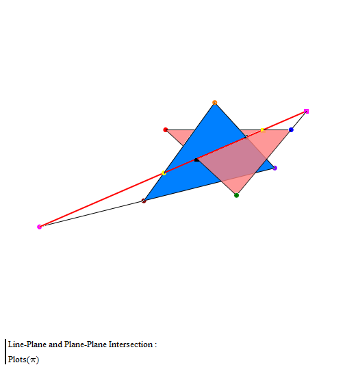

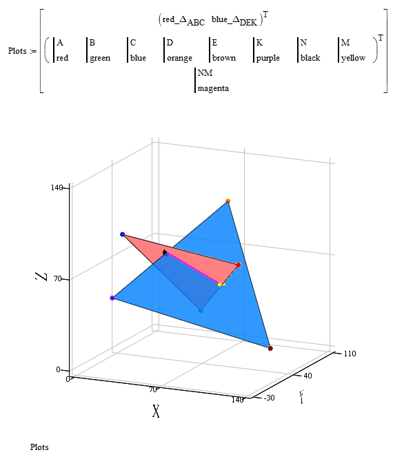

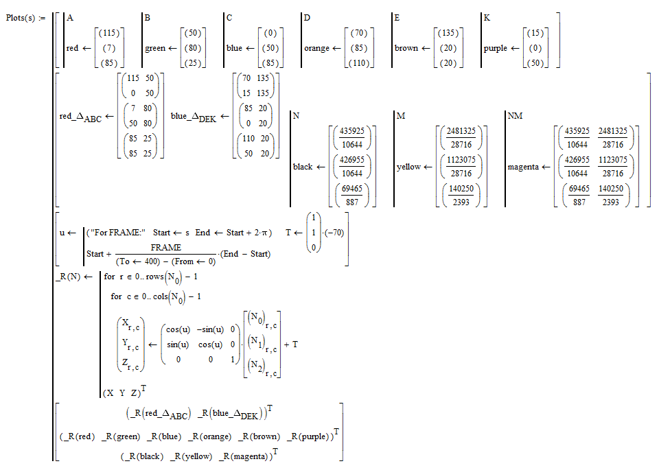

      Hi, Valery. :
      00. Line-Plane and Plane-Plane Intersection 1.png00. Line-Plane and Plane-Plane Intersection 2.png
             Regards.
