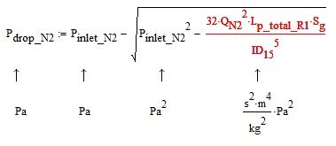

I'm quite new to MathCAD and I'm having problems with a unit somewhere in this BCGA pressure drop calculation. The error is "This value has units: Length^2 . Time^-2, but must have units: Pressure^2.
There is one input in the formula that is unitless (Specific Gravity), I wondered if this was causing the issue.
Any help would be appreciated! Thanks

I should guess that specific gravity needs units: weight per volume.
Essentially mathcad is telling you that your units aren't balanced.
You have P.drop, and P.inlet values that are pressures (Pa, n/m^2 or the like, bar in your case).
Now the large quotient under the root must have units of pressure squared (in order to be allowed to subtract it from P.inlet_N2 squared).
Copy that quotient outside of the root and evaluate it to see what unit Mathcad gives the result. Then you'll easily find what needs corrected.
There's also a magic number (32) in the expression. Does (should?) it have units?
Overlooking all, I see you (at least appear to) reference standards. Standards are a great source of formulae that lack physical basis: empirical formulae. Such formulae have a habit of requiring values with specific (implied) units, that will often not balance. If that is the case here, you should divide the implied units out in the expression, and add them later to the result.

Something is missing in the red term.

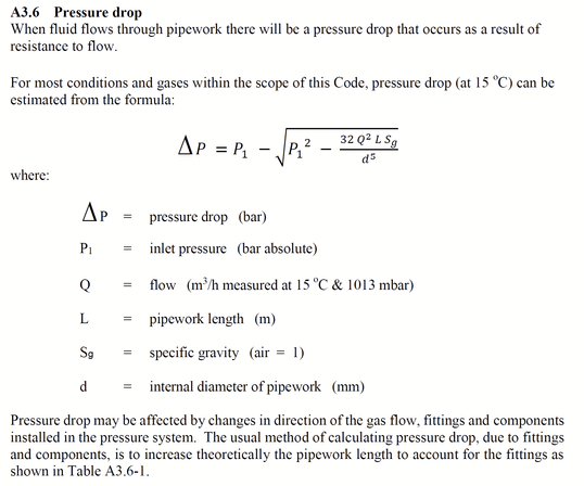

As Luc already suspected, you are applying an empirical formula to estimate(!) the pressure drop, which is not unit-balanced.
I found a reference here: https://dokumen.tips/documents/bcga-cp4-industrial-gas-cylinders-and-gas-distribution.html

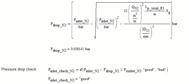

So you should do as Luc suggested. Make all variables used in the formula unitless by dividing them by the units given in the reference document. You may then add the expected unit of the outcome ("bar" in this case) at the end:
Thanks for this, it seems MathCAD has default units no matter how you define them within your calculation inputs. So what you did here worked for me also, thanks for your assistance and such a detailed response! 😀
