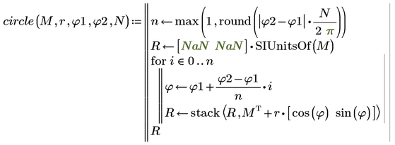

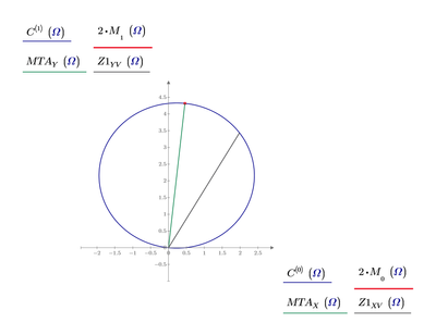

I had a circle function that was working fine until I re-defined some of the variables as Ohms-secondary.  The plot is blowing up now and I'm not sure why.  See attached.
Thank you!  Yes, that seems to be the fix.

Silly (and IMHO unnecessary) as it may be, Prime insists that the NaN's must have the same unit as the rest of the matrix!
So the fix is to add the units - I am using the SIUnitsof the center M which must be the same units as the radius r.

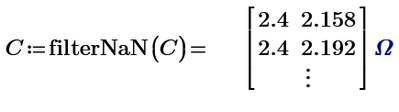

Or deleate [NaN NaN] of first row.
