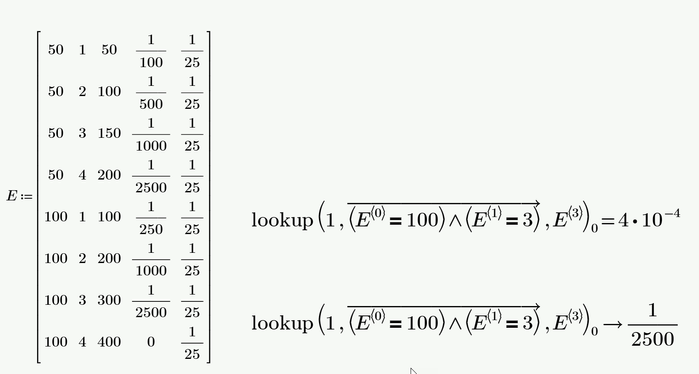

I'm brand new to Mathcad so apologies if this is a silly question. I'm trying to figure out how to check inputs for columns 0 and 1 to provide an output in column 3. In this case colum 0 input is 100, column 1 input is 3, and therefore column 3 output should be 1/2500.
With Excel i would use XLOOKUP and use '&' operator to combine 2 inputs. However, I can't figure out a way of doing this (yet) with Mathcad. Any advice?

Maybe that way
Prime 9 sheet attached

Hi Ciaran,
welcome to the community.
Here is one way to do it.
Cheers
Terry
Thanks very much, that was really helpful!

Maybe that way
Thank you very much, that was really helpful! That solution worked perfectly.
