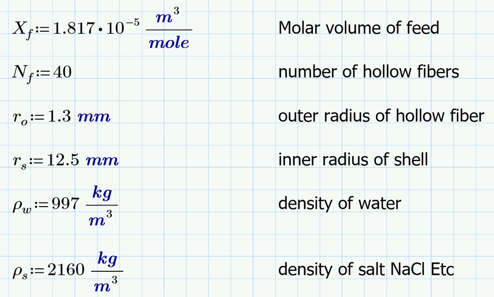

Greetings!
I want to solve this problem using rkfixed function in mathcad prime 2.0. Help would be highly appreciated!
I am having trouble understanding the derivative matrix of this function

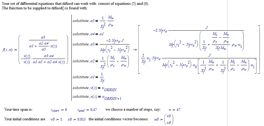

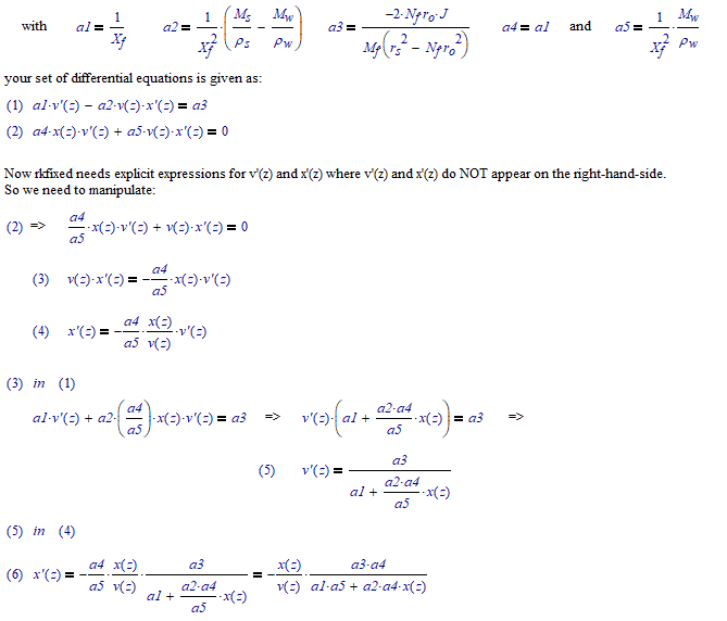

I think first you have to clear up what the function x'(z) is. It is not defined. Do you need to solve two functions ( v and x) simultaneously (which isn't impossible, but requires a set of functions to rkfixed.)?
I suggest you look up the example  for "Solving a First-Order ODE Initial Value Problem" in the help. That should explain the usage of rkfixed.

Right! I have two equations which contain v(z), v'(z), x(z) and x'(z)
the rest constants are known
initial conditions are known: v(0)=1; and x(0)=0.013
I need to solve it from ini=0 to end=0.47
I need assistance in forming the derivative matrix. It would be highly appreciated!
Further in the first equation we can assume the value for variable x'(z) as a constant as 0.5 and put the values of v(z) and v'(z) in the second equation to obtain x(z) and x'(z) then iterate the procedure.
I need to use rkfixed to do this.
Thanks!

With two functions to solve, v(z) and x(z), you need a set of two differential equations. So far I remember seeing only one differential equation, that's not enough.
Please provide the two differential equations involving the derivatives of v(z) and x(z), preferrably using ONLY symbols on a Prime sheet (NOT just a picture). For now I don't need the values of any constants...

@LucMeekes There are two differential equations in the sheet and thats all there is to the equations

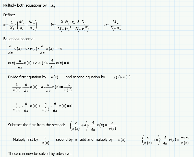

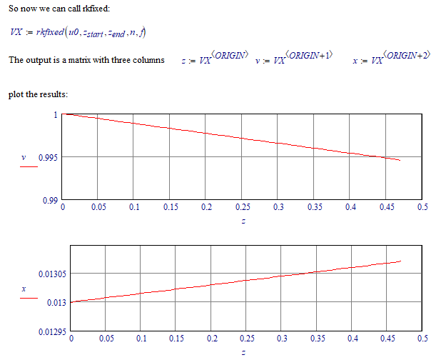

OK I found them (they are there today, they weren't yesterday. I wonder where you grabbed the second from...because both equations define v(z)*x'(z). And I wonder why you use d v(z)/dz on one occasion, and all other derivatives use prime notation:  v'(z) and x'(z)...?
Anyway, here goes:
With such results choosing 47, 470 or 4700 steps makes no difference in the graphs.
Possibly not the solution you expected.  I suggest you check your differential equations once more.

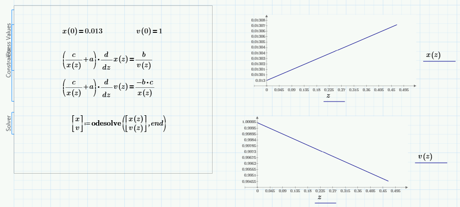

With a little manipulation these equations can be solved by odesolve.
Alan
LucMeekes
(To:AlanStevens)
Which gives the same results as rkfixed... Two different methods giving the same results, improves confidence.
I've tried to see if a v(z) and x(z) could be linear functions (e.g. v(z)= b*z +c). Alas, that does not solve the set of DEs.
No, they are not linear.  They appear to be simply because of the magnitude of the constants.  Increase Xf by two orders of magnitude for example (probably completely nonphysical!), and you see a distinctly non-linear output.
Alan

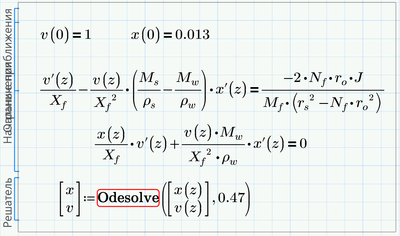

I tried to solve the first equation but it gives an error saying about derivative function D that this function cannot be used here.
File is attached.

One more try - with Odesolve - why not!
