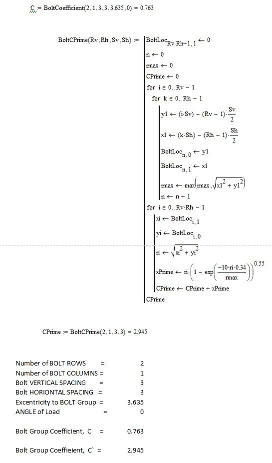

In the time it takes to faff about with Windows and Microsoft 365(Excel) settings it is easier to simply replace the two macros with Mathcad functions for C and C' thus ellimination the need for the excel embedment altogether.  Just translation of the macros line by line.
Here are the two macros in the file provided and they have been checked as working as long as you don'[ enter 1 x 1 bolt groups.

Hi
See enclosed file
Works great.  Thanks tons!

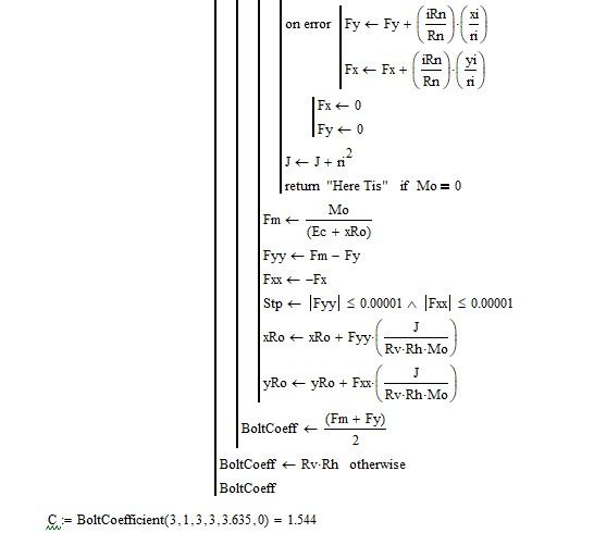

In the routine for Bolt Coefficient C if the first input parameter (number of bolt rows) is 3 the routine gives a divide by zero error.  I can't find where it is occurring. Can you find it?

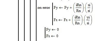

Found the missing piece.  When the bolt group has a bolt on the centroid "ri" for that bolt goes to zero.  So bolt groups like 3,1; 5,1; 3,3; with a central bolt fail.  In subsequent statements for Fx and Fy the formula have a divide by "ri" or zero for central bolt.  The original macro gets a round this with an "On Error Resume Next" statement that I ignored in original translation from VBA to Mathcad as I did not know what it was there for.  Now I do.
Simple fix is to do the same thing in Mathcad
Encloses is a new BoltCoefficient() program you can copy and paste in your sheet after deleting the old one.

Well I can't seem to get this to work either.  Same divide by error.  I even got the error when I opened the macro in MathCad 15 and I did not change a thing.

Sorry uploaded wrong file my bad!

Enclosed v3 of file without my debug statement testing Mo = 0
